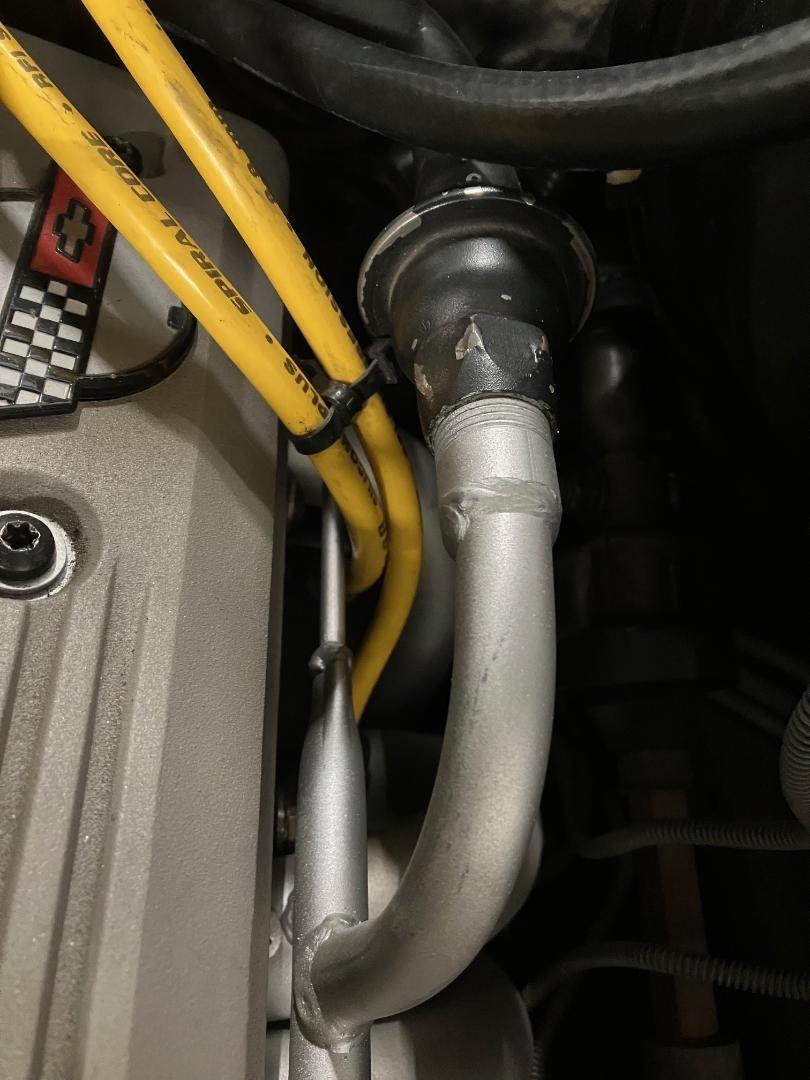

Thinking about removing the smog pump.
I have headers that have the tubes.
Is there a cap that can be used to replace the valve?

Pretty sure the threads are ½" NPT. So, yeah. No problem.

I used a brass npt fitting for 10 years. I totally got some harassment for it but it worked. When I needed to re-coat my headers I cut the tubes and welded the holes closed. Had them for 3 years after that and had no issues. Not having the tubes makes it easier to work on and around the engine.

I'll paint it silver to match.
Next time time I remove the headers, I'll do the same.
Did you use a shorter belt or a idler ?

Idler pulley is the better solution because the upper bolt attaches to the block and it is unsupported with nothing in that spot. They're on ebay for like $40.
You can weld 'em up on the car.

I ordered the idler pulley and will get the caps for now, I'll have the tubes welded after I remove the manifolds,they will get coated again after.
Tuning it now with the help of ULTM8Z so the smog will be deleted in the tune as well

T4C - It seems like a case of frustration meeting humor. I read your comments the way I think you intended, and caught on that there was useful direction there. BB73 apparently was in no mood for humor and wanted a direct answer, but as we know, there isn't always one of those since every installation varies once the bone stock configuration is altered. I understand that also, after getting so close and needing to iron out all the wrinkles in the details.
Incidentally, do you have a plan for the upper water outlet? That looks interestingly snug up there.

Thanks for the perspective, Vader.
If ^that^ is directed toward me and pic I posted, you're absolutely right; that water neck wouldn't work at all w/that set up. I did that years ago...2018ish? I used a L31 Vortec water neck and upper hose which ran the hose behind/around the back of the alternator. Like this.
