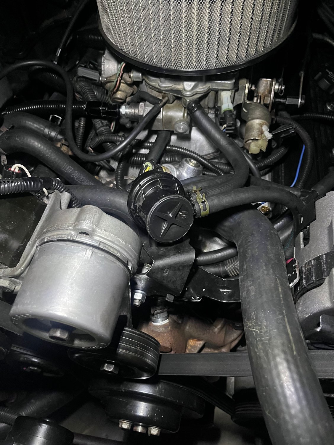

When I bought my car the emissions equipment was all removed. The factory engine is long gone, but I want to get the purge system working again. I recently installed everything and it seems to be functioning but I’m getting a very inconsistent idle (previously idle was spot on). When the TVS opens at temp, the idle jumps a couple hundred rpms. Im running all new hoses except the hose from the canister to the TVS. I would assume it’s a vacuum leak from either the valve or the TVS. Thoughts?

Here’s how I have it plumbed.

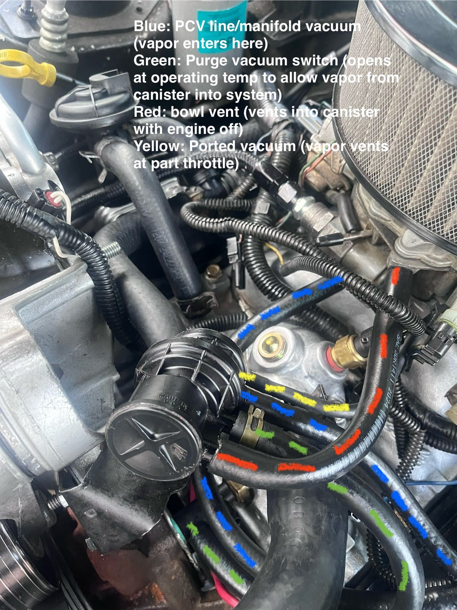

the vacuum tree I bought from Amazon had a badly soldered pipe. It broke just connecting the vacuum hose and was causing a major vacuum leak.
Also, I mixed up where the purge and bowl vent hose connect to the canister purge control. I’ll repost my diagram with the proper setup like below.
Vacuum tree was poor manufactured. Don’t buy this one from Amazon!
Proper setup.
Proper setup.

Re: High Idle With Purge System Installed
That should solve a couple problems.
