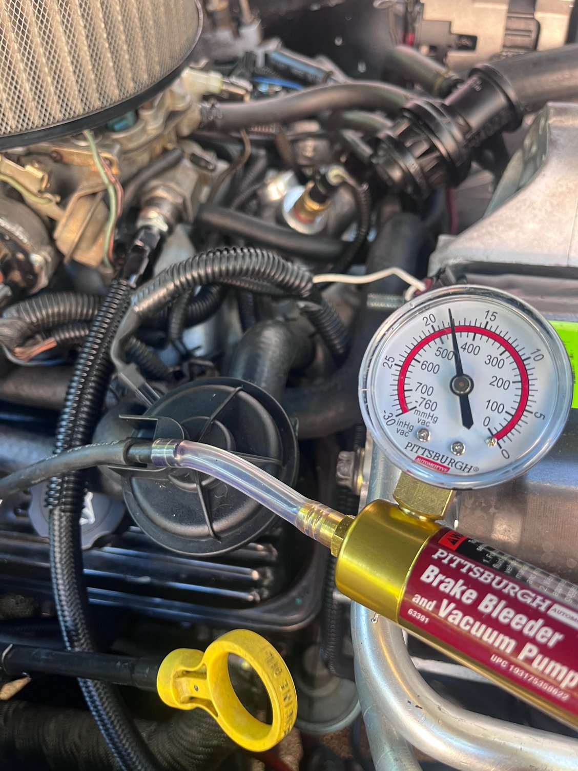

the heater valve appears to be doing the job, however, I needed a solution to trigger the valve. From the factory, I believe it received vacuum via the max air setting. However, I opted to go a different route and trigger the valve to bypass anytime the AC compressor is running. What I did was repurpose a GMT400 vacuum actuator and tied it in the circuit with the throttle kicker solenoid. Typically, I’d run a relay with a negative output as a ground trigger, but my understanding is that this solenoid will pulls very little amperage.
GM#NV236. Shares a vacuum source with the HVAC. The factory reservoir/check valve prevents a drop in vacuum when accelerating.
Here’s the vacuum reading with the AC engaged. Not a bad vacuum signal for a mild 350!
I would advise STRONGLY against that.
Reason being, the compressor runs when in Defrost. Meaning, in your scheme, you'll have no heat to the windshield EVER in Defrost.
Better plan would be, get the little vacuum valve disc thing out of a car - almost ANY GM car from the late 80s / early 90s - and run another of those thin plastic vac lines through the harness into the engine compartment to the heater valve. You should be able to just push one through there. Doesn't have to be very large. Worked GREAT on my 83 car, same overall situation as yours.
