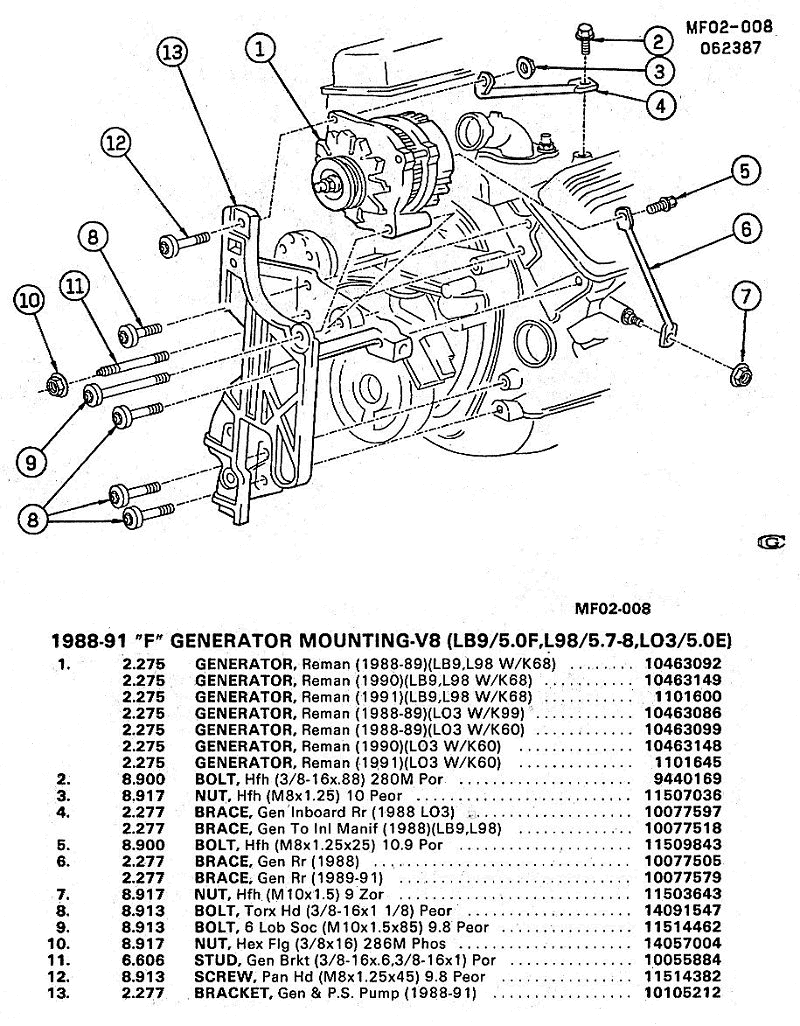

Hey guys, anyone have a link for the bolt sizes for the TPI serpentine brackets? I'm rebuilding my engine and I'm getting ready to put the brackets on and I can't find the bolts. I put them in a zip lock bag somewhere, I wanted to do regular hex head bolts anyways. As I'm typing I also can't find my water pump pulley bolts. The ones pictured are too long lol. It doesn't even spin now.
There were some ten year old threads on here but the links no longer worked. Any help would be appreciated 👍🏻
