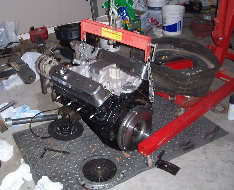

And here's a picture to keep everyone amused.
