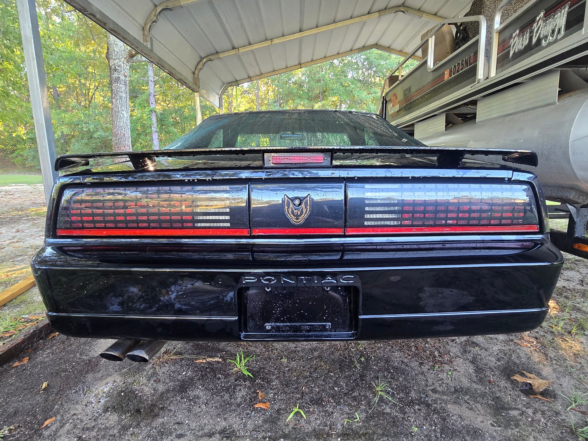

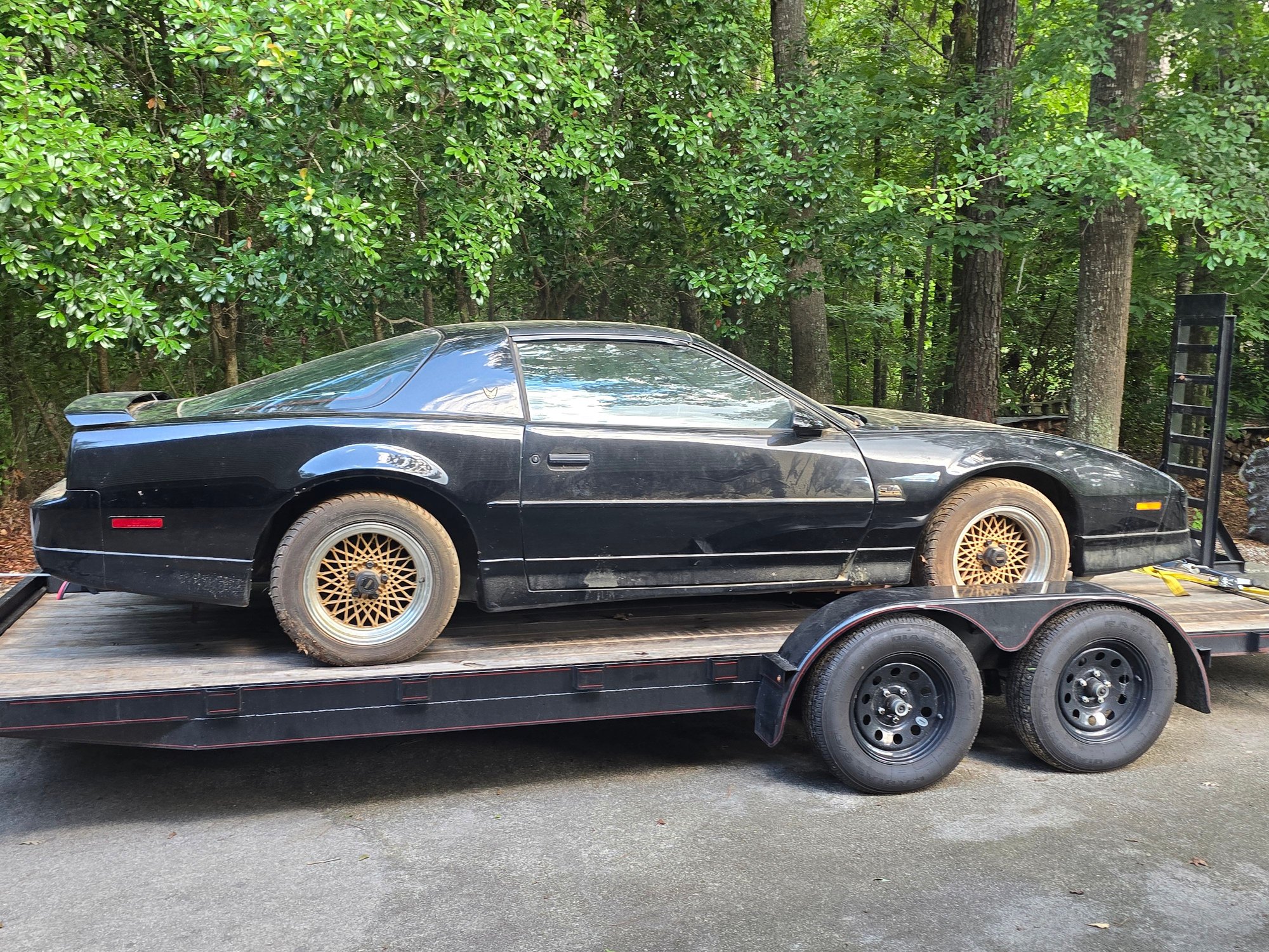

Here's a little back history real quick. Finally was able to buy my first Third Gen after years of owning an 4th gen. Barn find in a guys shop has been sitting for 5 years under a canvas cover. Black on black leather 89 WS6 GTA. My jaw dropped, purchased the car, brought it home on a trailer. Also guy i purchased from said the car went through a bad divorce, (curious if something could have been done to sabotage car).Put in a new battery and attempted to crank it. No start, but would run on carb cleaner. So started chasing fuel delivery issues. Ended up replacing the fuel tank, sending unit, fuel filter and fuel pump. Tried to start again, was only running on a few cylinders. Ordered new injectors, adjustable fpr and gaskets. Replaced all that and then car was finally running. Went ahead and replaced ignition control module, cap and rotor button. Now to my issue. Car will run and drive most of the time until it reaches operating temp. Then it will just die like you turned the key off. You can cycle the key off and back on and it will restart but if you just let it idle it will die within a few seconds again. Sometimes if you hold the throttle o er 2k rpm it will stay running then if you try to give it some quick throttle it will die immediately. Cleaned maf sensor, idle circuit in the throttle body, and sprayed carb cleaner all over in engine bay looking for vacuum leak and havent found any. Have fuel pressure guage hooked up to monitor fuel pressure and has good pressure while idling and running. Also looks like there's a small oil leak somewhere behind the distributor because it's a little wet on the firewall back there. Ecm has already been replaced as well as that was a prime suspect. Can anyone on here help me diagnose this and get my baby driveable??? Thanks for any and all help.
