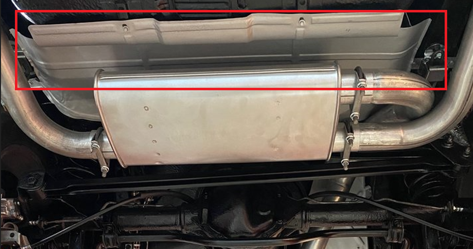

And to take this on a slight tangent...is there supposed to be any kind of plastic or metal shield under the tank? Mine doesn't have anything and I sometimes hear what sounds like bubbling/boiling from the tank after I've been out and about for a while and there's almost always a streak down the quarter panel below the gas door indicating fuel spillage even if I haven't had the cap off since the last wash. The muffler is only like 4-5 inches below the bottom of the tank so I am wondering if the heat from the exhaust is the issue and if there is supposed to be some kind of shielding between those two.

yes from the factory there is a sheet metal "heat shield" between the muffler and tank. You may also want to check or replace your vent valve, this should be blowing off excess pressure long before your gas gap, they are a common failure if they are original/plastic corroded https://www.hawksmotorsports.com/82-...oration-parts/

Well, crud. I don't have that shield/deflector panel and my google-fu is failing me on finding somewhere I can source one. I'll probably go ahead and toss that valve in my next Hawks order. It's not expensive and if they are known to fail, it won't hurt to go ahead and get it.
Any ideas where I could put my hands on one of those shields?

Bumping to ask again if anyone knows where I can get my hands on a heat shield as in the photo. My car doesn't have one and after driving for a while, I literally hear boiling in the tank when I stop....which doesn't seem safe AT ALL

Since your gonna be ordering the relief valve from Hawks, why not buy a shield from them as well? (you do know that Hawks sells used parts from cars they disassemble, yes?)
