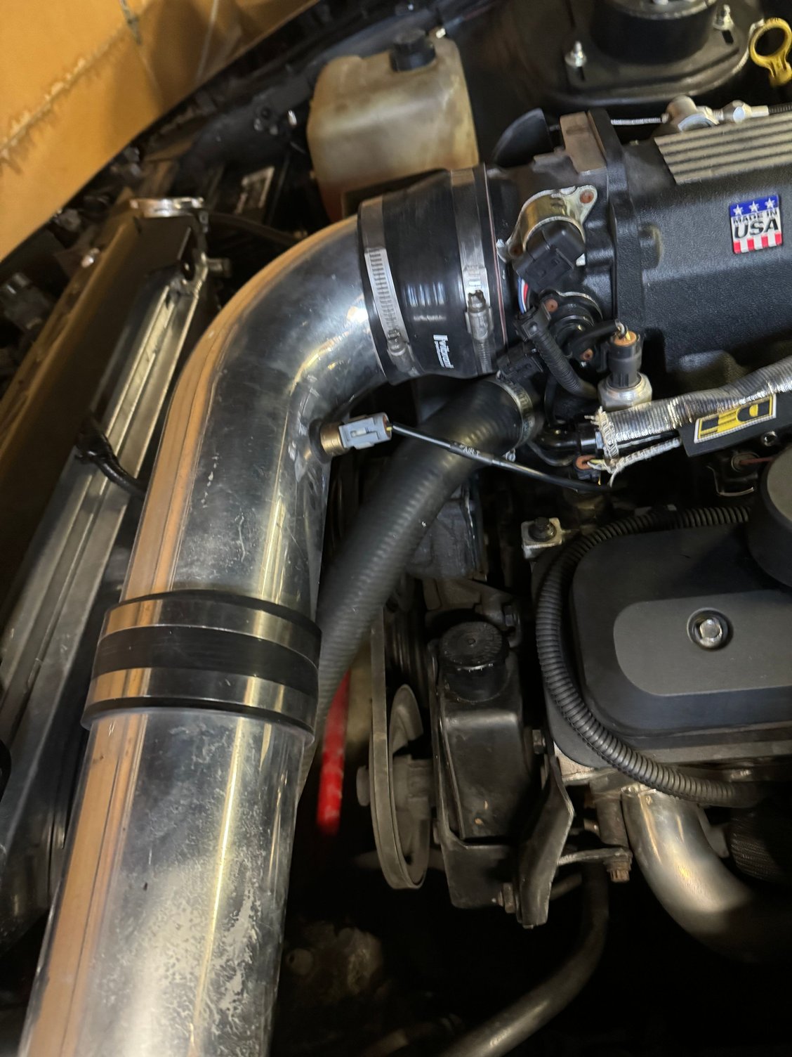

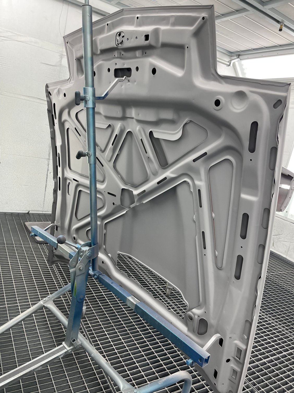

I know it's not an apples to apples but I have a pro flow xt intake on my sbc. It has a LS style TB. I had my TA hood clearanced when the car was painted. The hood slopes down more than Camaro hoods so it gets pretty tight.
the blower piping is close to the hood but the TB made contact. Prior to the blower I angled the intake pipe down a little for clearance. The last pic is the hood prior to paint. You can see the area cut in the center brace. That's where the TB made contact. It's a tight area.
