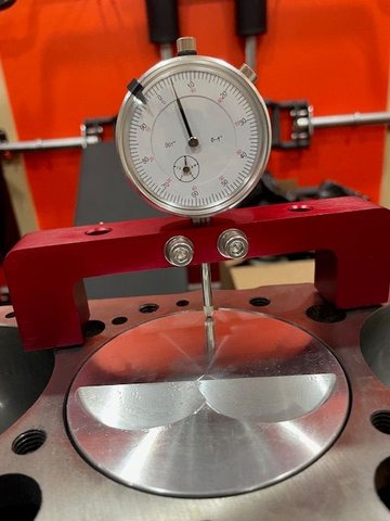

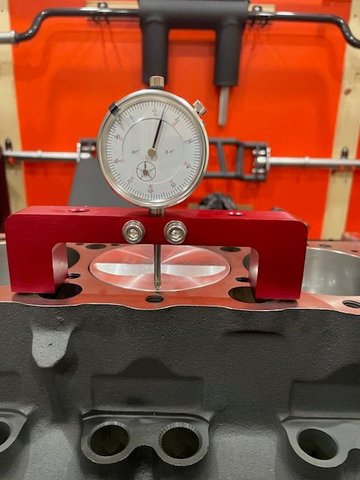

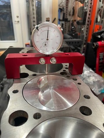

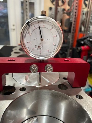

Yes, I was thinking I need to share pics as well. Here's multiple measurements of piston #3. Every spot I measure is different. All rings installed, couldn't really see any piston rock by pressing down on one side or the other. The first time I measured it I just slid the indicator from deck to piston and wrote down the measurement. I used .010 for zero deck height. Don't blast me too bad here; the last time I built an engine was in 2006. I'm sure I'm reading it wrong cause I now see it's different everywhere. I probably should just stick with center of the piston eh? Sorry for being a noob with critical measurements, but thanks for the help!

Just went to the school of Youtube. Looks like I need to re-measure everything. The machinist I used is solid; he's been in the business for 20+ years. My engine building experience...not so much! LOL! I'll remeasure all of them tomorrow at center of piston!

Ok, I'll take spears if you got 'em! I remeasured everything tonight at center of piston and I'm GTG! Here's what I came up with.
CYL1 = .000, CYL 3 = .000, CYL 5 = -.003, CYL 7 = -.003, CYL 2 = -.001, CYL 4 = -.001, CYL 6 = -.003, CYL 8 = -.003. I'm moving forward with a .039 gasket. Thanks for the insight fellas! I'll post up progress as I move forward...

If you care to measure yet again and wish to avoid any error when sliding the dial bridge from the deck to the piston, just use the dial to determine TDC and then a bridge micrometer to measure depth, The that margin for error is eliminated.
Just my two cents. If you have the time as you say, that's something easily revisited.
