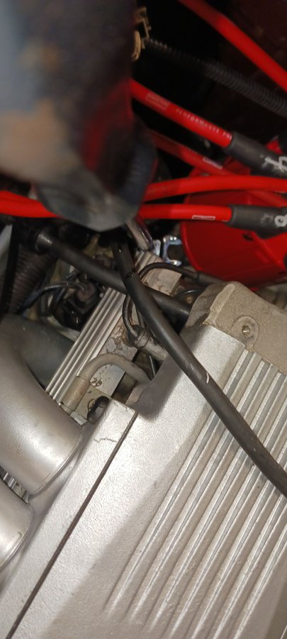

I've been using a 9/16 "crows foot" on an extension to reach straight down and turn the clamp bolt.
You can see the crowfoot adapter is on the bolt head. should be able to get about a 1/4 turn or so before you have to reposition the crowfoot for another turn.
