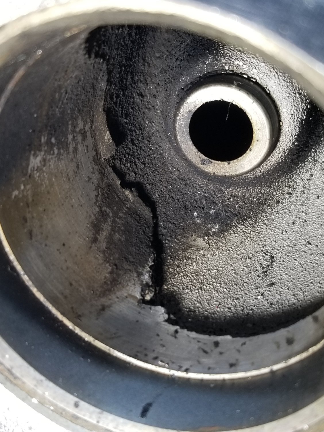

Welp.. I'm done....DOOONE, with one head. Time to start the next. Sure was hoping that I could find a flow bench for a before and after, but not in UT, I guess.
Look at this junk....
That is crazy! The ZZ4 113 heads were far, far, far cleaner castings that that. It is a miracle that tired L98 in your Kart made the kind of HP and TQ it did especially the power it had with the SuperRam.

I totally agree. I think the way they left those bowls is NUTS!....and I also agree that I can't believe the thing hit 289/375 wheel, with those ports!
....and everything else that was "wrong" with that junk!

I don't think I've ever seen anything quite like that.

Yup, seen a few sets just as bad..

Nuts! I can't believe you don't hear more about it on the 'Vette forums...or where ever. I mean...that has GOT to be some low hanging fruit right there!
