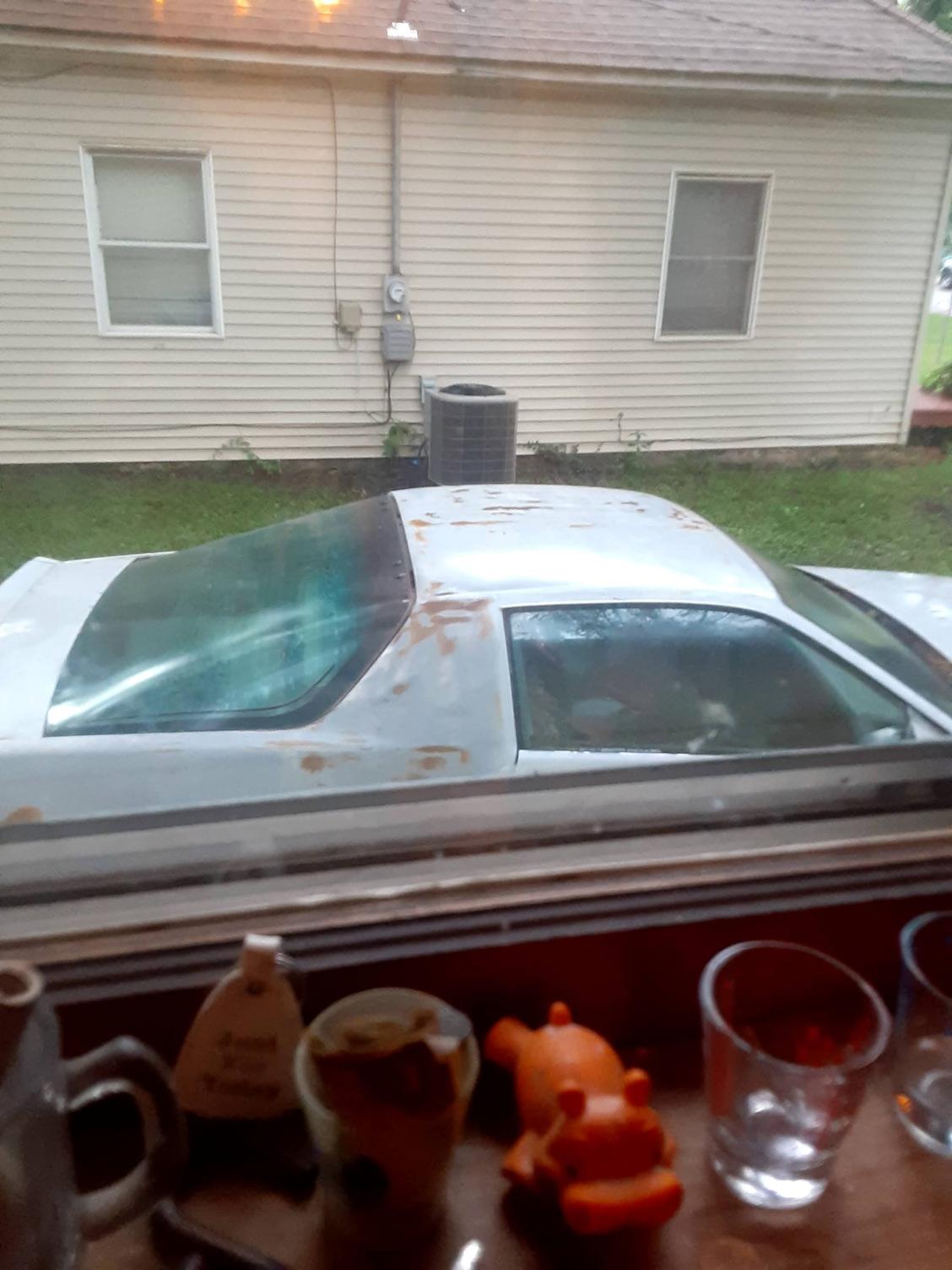

So my Son Josh died in a car wreck in 2008, he was 20.. I am working on restoring his 1983 Camaro .I had a friend help me restore the door locks, interior driver door was pretty much bare and is now done. Passenger seat is bolted down. A week before the parade last June the engine started blowing White smoke. I checked the antifreeze and it was low. It could possibly be a head gasket or cracked cylinder head. How would I go about finding out? I don't mind get greasy or dirty. I worked really hard on this car and it pulled this crap!!
Any and all help appreciated.
