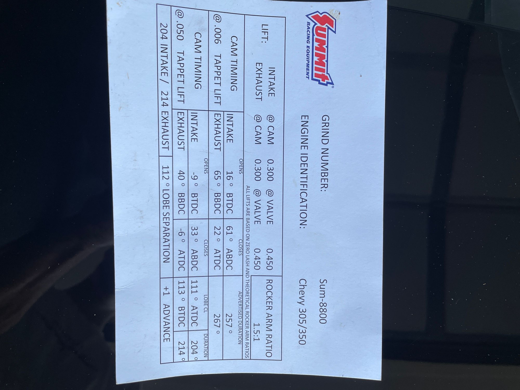

What size injectors do I need to run or will stock ones work. Pic attached

Looks like a relatively stock cam with a little more duration. You may not feel much improvement of the engine so OEM injectors should work just fine.

I run the 8800 with 1.6 rockers. It feels exactly like stock. You do not need to worry about injectors.
