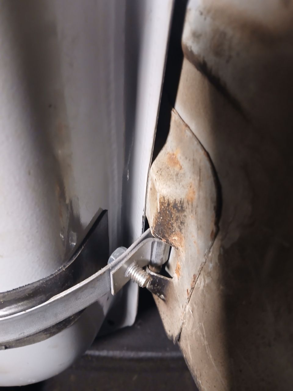

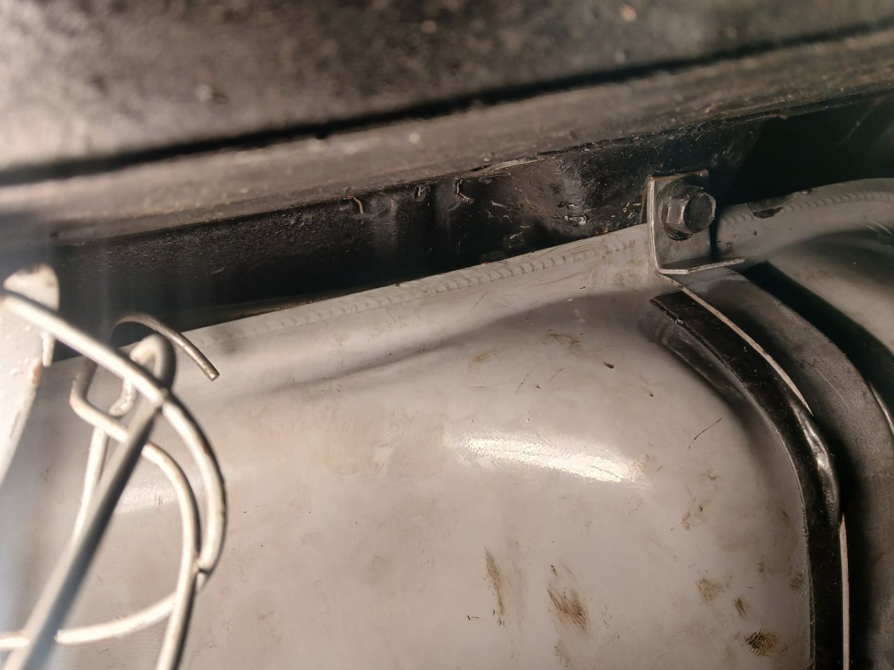

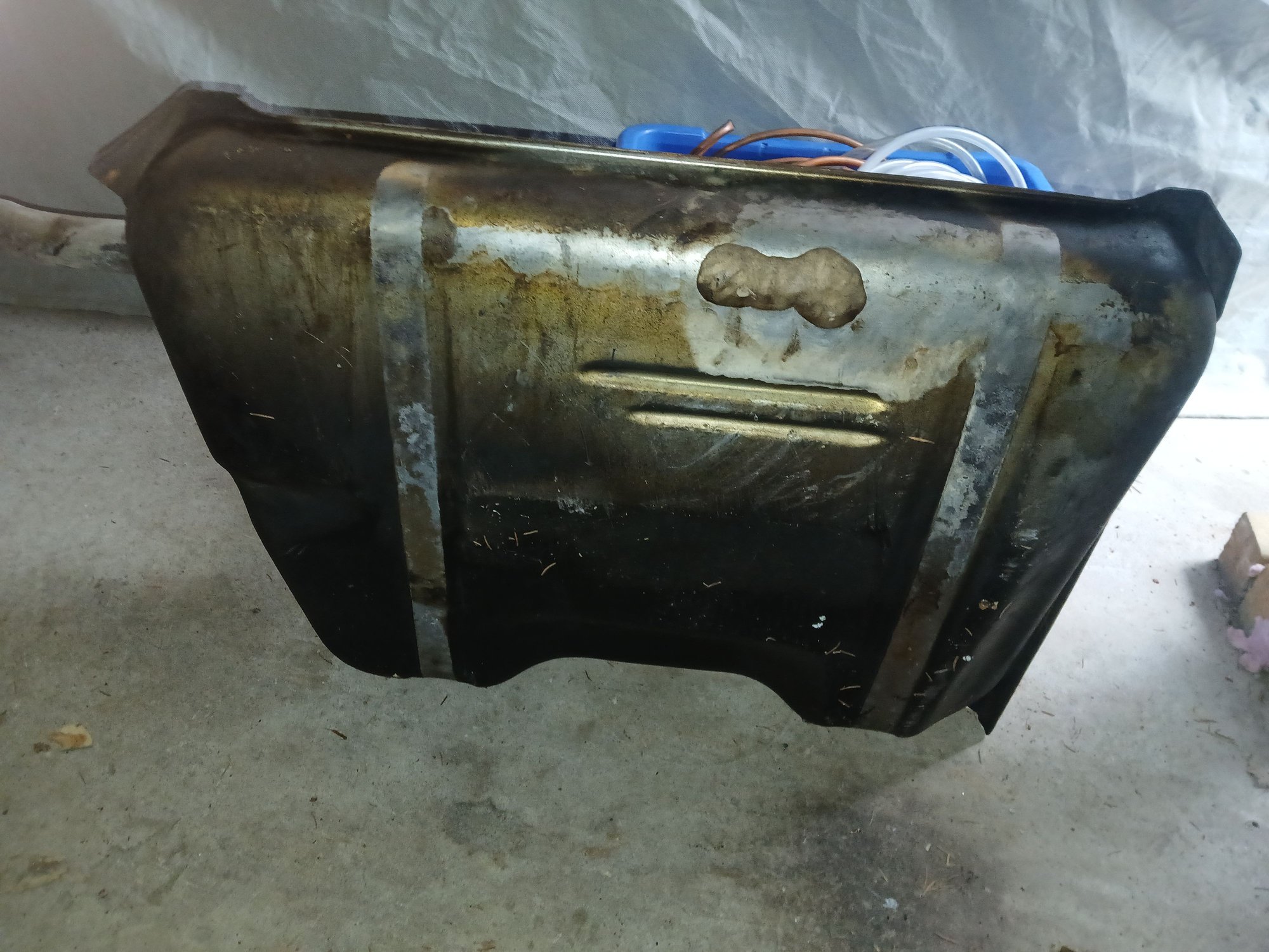

I went with the Spectra straps and could not get the tank to sit up in the enclosue 100% due to the tank seams. The tanks sits about 1" lower on the front bolt side, When I look at the factory OEM tank the front and rear seam are molded different and countoured. Not sure if the straps had a factor in this or because the seams are just slightly different. The tank is secure so It should not be a problem. Anyone else had this problem ? Should I try the factory straps or just keep it as is ? Any adivce would be much appresiated. See pictures.

I used hawks repo straps. They're a little different from the ones in your pics. As long as your tank is secure, I wouldn't worry much. Its not like you can grind the seams to make it fit differently. Hopefully you have good clearance on the heat shield.
