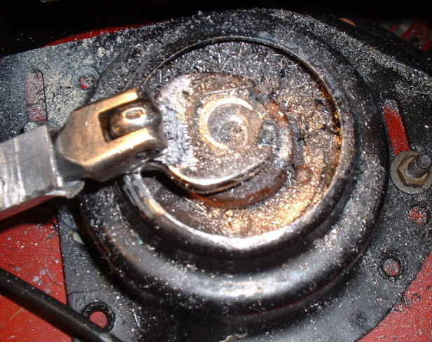

now what idiot designed the upper strut bolt, which is torqued to like 100 ft lbs or something, and requires like 200 ft lbs to get it off, to be a 10MM nut.. HOW STUPID can u get.... there is NO way that such a small bolt can handle so much torque.. especialy when taking it off. which is why my is stripped to pieces. nothing left to it, i have tried everything you an possibly think of to just get a grip on the bolt, 3 different pairs of vice grips, grinding down the bolt head to be square shaped, and it still stripped like it was made of lead!!.. well, the only other option i have now. is to drill out the freaking thing and get a new strut. but not untill i can drill out the stupid thing..

Try using a box end wrench and get a magnet and clean that crap up.

well, its not the OUTER nut that im having problems with, its the inner nut.. the one with the hole in it and all the shavings are cleaned now.. should have it all fixed tomorrow afternoon, just have to buy a 5/8" drill bit that won't poop out on me.

You have to understand what the engineer was trying to do. He (or more correctly, his department) was assigned the task of making the design easy and inexpensive to assemble, and still strong enough to serve it's purpose. I doubt seriously that the accountant who told them to make it easy to assemble ever mentioned that it would be nice to make it serviceable. That's why there are so many specialty service tools at GM dealer service centers. The person on the assembly line had a brand new, clean, and lightly lubricated thread and a counterbalanced torque gun to install the nut, they didn't care about the person who might have to disassemble it later, and neither did the accountants. I'll bet the engineeers knew all along that it was going to be a be-otch to service, but did it the easiest and cheapest way for assembly.
As for your disassembly, you really should have used penetrating oil, a 10 mil box wrench on the stud, and an 18 mil offset box on the nut. a high-offset box wrench suitable for the task is standard fare from Mac, Armstrong, Wright, Proto, and even Snap-On (they mnust be buying it from Wright again). Go to a decent quality supplier and you should be able to find exactly what you need. While you're there, get a small can of Never-Seez so that it doesn't happen to you again.

well, i tried penetrating oil, and later a butane toarch, no luck.

I had a similar fight with struts, like many of us probably have. It helps to have a lot of penetrating oil, some time for it to work into the joint, and the correct tools. Sometimes, the correct tool can be an accetylene torch set, especially when you get one of those really nasty ohnes like you appear to have.
If you ever have to do the other side, let it soak in penetrating oil for a week or so before tackling it, and wet it down every day or so. A lot of really stubborn fasteners can be coaxed in that way, even the really ugly exhaust parts. But keep that cutting torch handy just in case. Sometimes you can't beat the old "gas axe".

Just a words of advicxe,have you ever tried the craftsman robogrips?there awesome..best tool i have ever used/seen...

If you're going to replace the srtuts anyway, you could try clamping some vice grips on the strut rod underneath in the wheel well. Worked great for me!

You need two things. Actually one of three things.
A Dremel and a cutting disc made for metal, a nut splitter, or an angle grinder.
I've had the same problem as breathment, and the worst part was that it was a new one that went bad and I had to take it back to AutoZone for warranty.
If you use a Dremel and a cutting wheel, just make two cuts on either side or the nut and whalla, it's off. Or use a nut splitter. But the Dremel is much more fun. Just make sure you don't cut into the bearing unless you plan on changing that also.
If you use an angle grinder, just cut the shaft in the wheel well. Again you will need a cutting wheel, but it's probably just as much fun as the Dremel, and louder to!!!
