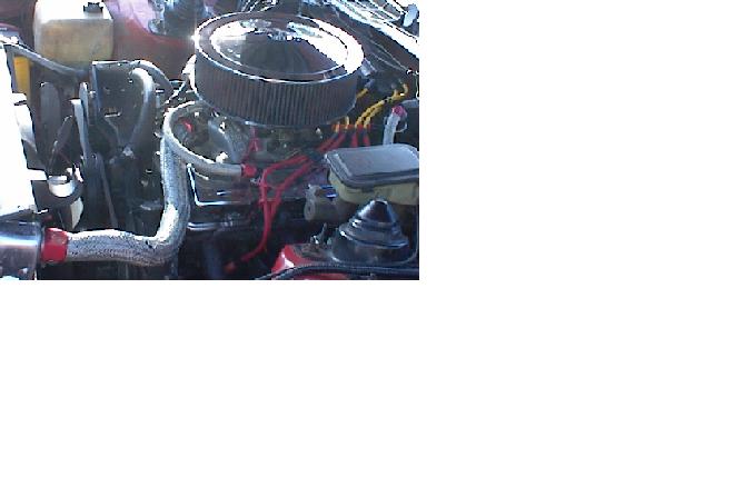

I use the Spectre sleeving. Comes in different colors. It's rated for up to 1400*, which headers don't get much hotter than 1200* I believe. They're 12.99 for 10'. I only bought one package, and ran short about 3 wires, so just order 2.
There are other brands that I am are better, but that gets around $60-$80.
They also have high temp boot sleeves, but I would think you could use it on the whole wire, about $35 for 1 ft. rather pricey, but stands temps up to 2300*. Just do a search on www.jegs.com for braided plug wire insulation.
Here's a pic of how they look, unfinished though.
