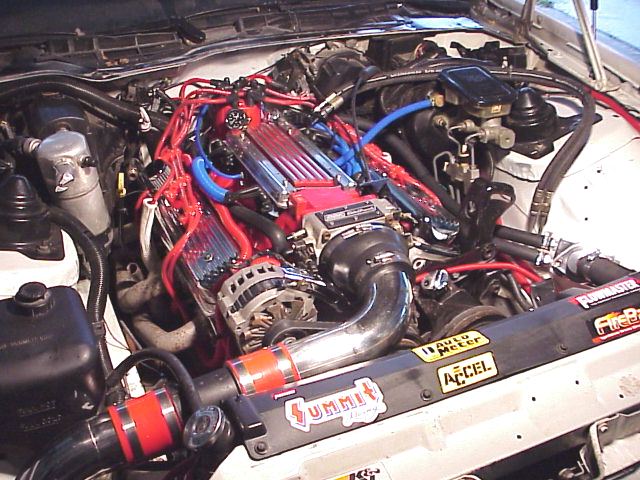

I'm finished, but my starter died the night I was going to start tuning. I bought a new one but I've been too busy to put it on. I think I might have time tonight to get back on it. This swap has taken me a long time to complete, but I think it will be worth it. I'm only a few scans and chip burns away from finding out.
