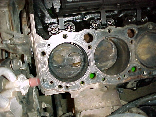

probably won't do much but here's a pic of the cylinder if you can make a measurement off that by relating it to the size of the lifters.
Attached Thumbnails Wha to do to get the 305 TPI into low 14s-enginecylinder.jpg

run 3
bumped up timing for this run a little and bumped fuel up a little
15.67 @ 90 2.6 60ft
car almost died on take off. stupid injector
so i decide to give it a little more timing and some more fuel and see what would happen and i would be done for the night
run 4
19.6 @ 46 2.5 60ft
launch was better than last run but still felt really weak. shift into second and that felt good, climbing 2nd and rpm's stick at 4500 rpms. i push in the clutch and let off the gas and the car dies. i try to pop the clutch in 4th to restart it and it won't start. so i pull off and look for coil wire to have slipped off and nope. so i go back and after a little cranking it starts up with some pretty loud clanking and ticking. i listen and it sounds like a rocker arm broke or came off or what not.
so i get it home and this morning i pull the valve covers and all the valvetrain is fine so it looks like i spun a bearing. i don't see how since i didn't touch anything down there but i guess it was just time for it to let go.
i guess i'm gonna just get a crate 350 shortblock or something for now because i don't have the money to build the 400 i want but we'll see.
good luck to everyone else and i hope this doesn't happen to you
Andrew
p.s. funny thing is my 19 was faster than some ricers hahahahaha

sorry to hear about your engine crapping out... mine died in 2000 - i had it rebuilt by a shop since i needed it in 5 days - they put a peanut cam in my 305 when i originally had an l98 cam (massive stalling and problems) it took me months to figure thos out too - not to mention the 2000$ i spent on other parts ie Ignition/fuel system... so after 6 months I was able to get enough money together to buy the cam i wanted - but alas my engine was destroyed in the installation process... lol - hope you have better luck

well i'm just getting a remanufactured 350. a fast 305 is nice but why pay more to rebuild it than you can pay for a rebuilt 350? so now i can't wait shhh don't tell anyone

Sorry To hear that Smokin... Seems like every 305 that Starts to get fast, Falls Apart
On your Baseplte, Why Didnt you Go any wider with the Siamese ?
I wish I had a camera to take a pic of mine, But What I did is I went in about 2.5" But I widened it out so the vertical Space between the two Runners was nearly as Large as the Runners Themselves.
I cut a teardrop around the lower bolt hole, and Just pushed the Upper Ridge to the limit of structural integrity.
The problem Im Having now, Is I can't get my Grinder in Any Farther. I may try It Just like this, and Then grab myself a second base Down the road and Put it on a drillpress and take it down 5 or 6 inches For comparison.
Seems to Me that you need about 4-4.5" To get the real effect of being able to pull from both Runners... But Some people say no... I guess only Timeslips or Dyno PUlls Will Tell )

the 15.2 was my first time to the track. if you look at the mph you will see that i really only gained 35 hp. thats not unreasonable. 10 for free mods 10 for headers(dyno proven) 10 for y-pipe 5 for a cooler night and less humidity. plus i just put fresh plugs, wires, cap, rotor blah blah blah... on it. the biggest deal was i learned how to drive the thing!
Bort62...
i didn't do the teardrop thing because i didn't know how much material there was. since i have to have the intake off again i'm gonna go ahead and port it some more and do the teardrop thing you are talking about. thanks for pointing that out
Andrew
