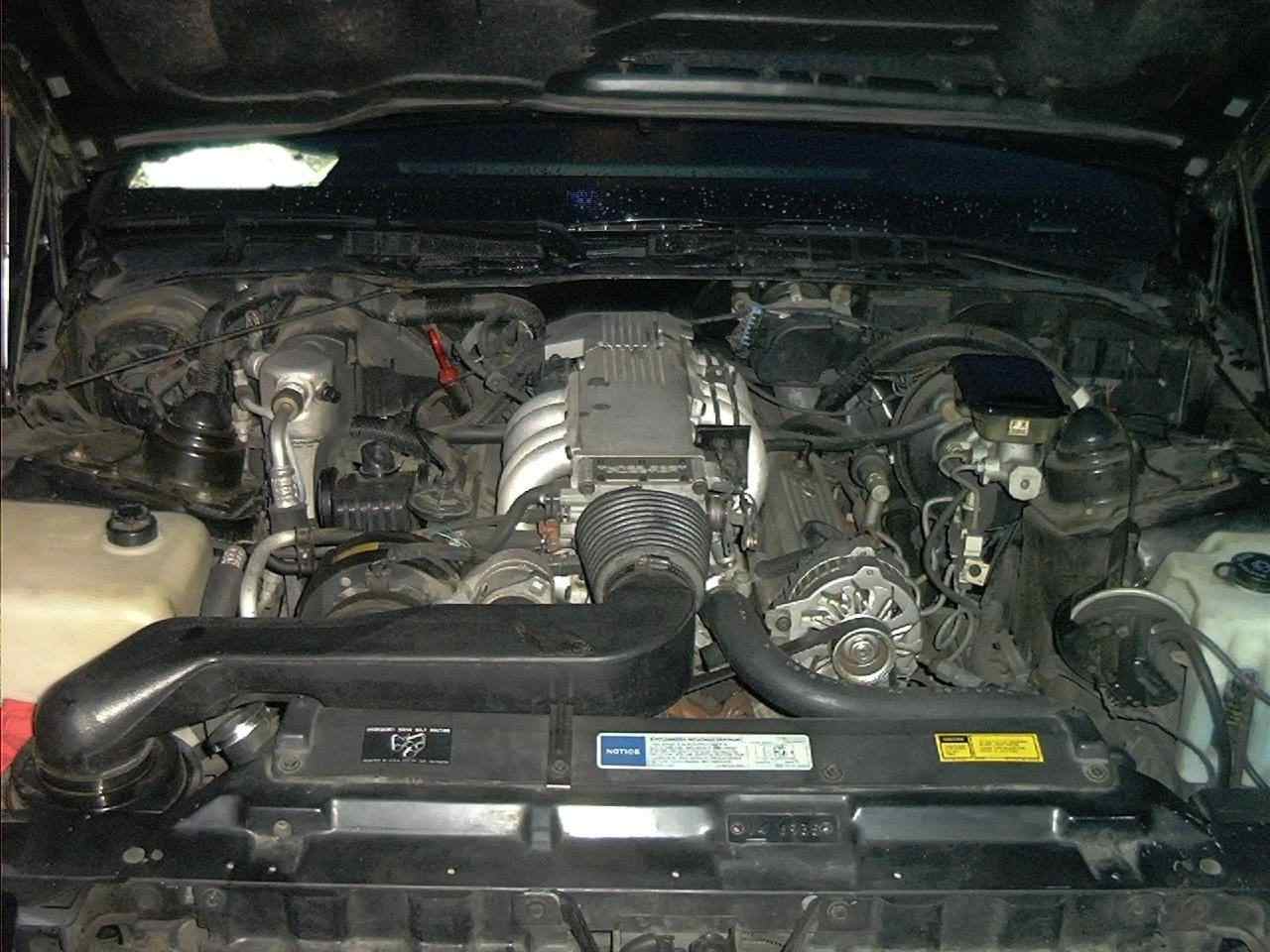

Here's my 91's TPI

my engine bay looks similar, but the dirty version
