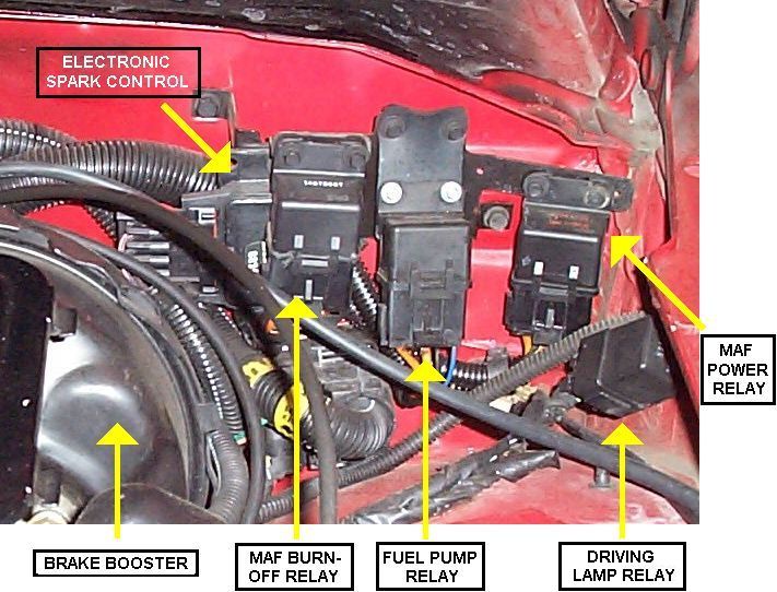

Where does the knock sensor plug into (on the harness side not on the block). As far as I remember, one end is down on the lower passenger side of the block (white plug). Where is the other end?
Old Mar 13, 2003 | 08:57 AM
Cruzin Kaz's Avatar
Posts: 3,331
From: Welland, Ontario, Canada
Car: 85 Monte Carlo SS...
Engine: T.P.I L98.
Transmission: TH350
Axle/Gears: 3:73 Posi
The other end stops at the ESC module.
Old Mar 13, 2003 | 08:59 AM
Steve89GTA's Avatar
Posts: 1,566
From: Toronto, Ont
Someone wanna refresh me where that is. I've been working on the bike for the last few months so my head is somewhere in japan.
Does it go through the firewall and behind the dash on the passenger side?

Here Steve. Hey you should check out our Ontario site too if you want. www.sogm.ca
