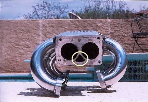

Here is a pic of my old 85-87 plenum, the triangle hole in between the TB butterfly holes is what the IAC sensor uses to idle.
On the 89-92 plenums, there is no 3rd triangle hole, just the 2 butterfly holes. The 89-92 TB's IAC has been modified to use a different idling setup. This is why I couldn't use my old 85-87 TB on the 89-92 TPI setup.
I don't have pics of the TB's or else i wouls show ya.
I hope you get a better understanding as to what I'm trying to say

So 5SIZ....if I change the TB....without hooking any cables up...and control the throttle with my hand....it should tell me right then if it will work properly right? I just don't get it how some of the guys have changed their TB's over..and didn't have any problems....oh....and would someone get the same results if this would be done?..vice versa?...85-88 TPI with an 89-92 TB.....89-92 TPI with an 85-88 TB?

well when I tried it with the 87 TB it would start up and die, but if I would start it up and start giving it gas, since the throttle blades would open the car would stay alive, but barely & when I would stop giving it gas the car would just die.
I have no idea what everyone elses experiences with this are.
Maybe the after market TB are universal? who knows, I'm just giving you a heads up so if you get this problem then you will know exactly whats wrong.
let me know what happens.

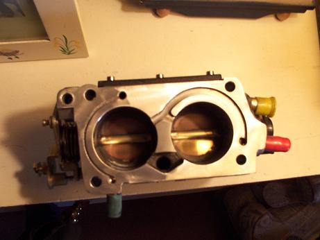

This still isn't making much sense to me....lol..sorry!! Ok.....here is a picture....I see exactly what your talking about (the notches in the twin bores).....what are the notches used for? I haven't taken ANYTHING apart yet....and probably won't for a little while...I'm hoping I can do this successfully...I'm not much of a mechanic at all. And...nope..I haven't sold it yet.....I just don't want to mess anything up....and JMatlock88...you did the same exact same thing to yours too right? I mean...adding an aftermarket 85-88 52MM TB to an 89-92 Plenum? And it was fine? Right? sorry if I'm repeating myself.....i just want to make sure...I'm not digging myself hole here....
The notches allow the idle air to pass through the triangle shaped hole or through the twin bores if there is no triangle shaped hole.
No, I just know what I'm talking about.
I run a stealth ram. It's plenum does have a circular hole between the bores, so it can be used with either style of stock throttle body. That's becide the point.
You're not digging a hole, just rest assured that your TB will work fine with a simple cable swap. They designed it this way on purpose to save money. (so they dont have to make two different castings)

Agreed to JMatlock88. After seeing the picture of your TB it is machined to work with both stock plenums. I imagine the only reason BBK speifies 85-88 and 89-92 is that they accomodate the cables different. get the cable to work and your all set.

That's great to hear that someone did second what JMatlock88 has said! I know the 52MM won't really do much....as fas as power, performance, or anything....but..I hand polished it, and it will be a good addition to my exsisting TPI set-up.
