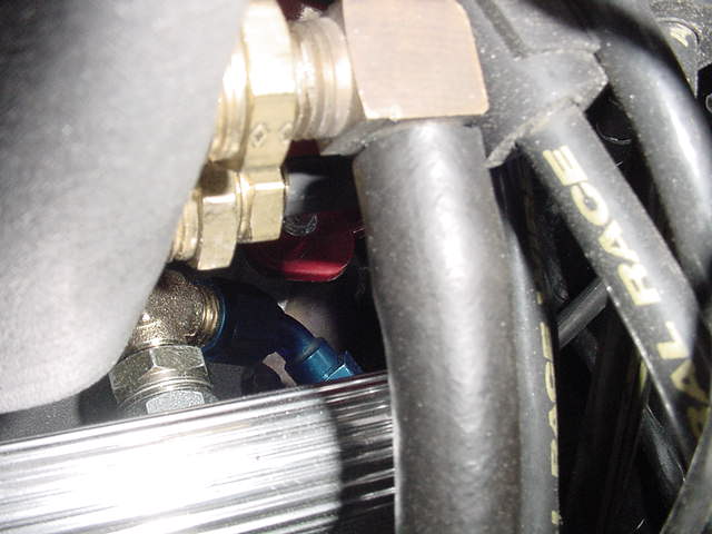

I take it you mounted the FPR according to Holley's instructions. I mounted mine the opposite way (adjustment screw facing out, fuel fitting facing inward). Anyway I figured it would be much easier to adjust this way.

Yes I did mount the regulator like the directionssay. I was gonna mount it the other way but I didnt want to run into a problem with the fittings hitting the dist. IROC, do you have a picture of how yours is mounted and what size and angled fittings are you using

I used the 90 deg fitting Holley supplies for the regulator return line. I pointed that fitting about 45 deg downward. I then used Earl's 45 deg -6 AN fitting for the return line. It's kinda hard to see in the pic but you can see the dist cap hold down screw...that's the closest part of the cap the fuel fittings will come close to. The only drawback to this is you may have to remove the dist cap to tighten/loosen that fuel line, but no biggie.
