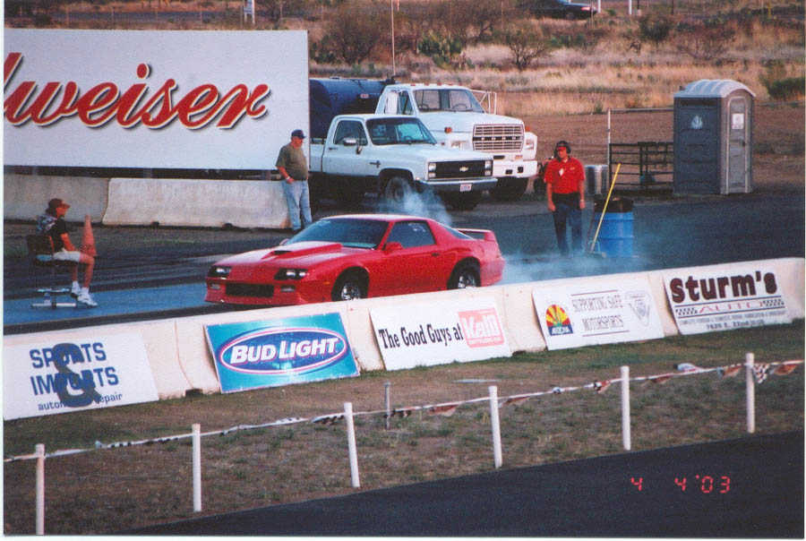

I was thinking about starting a separate thread for this, but tonight was fun.
First run: Burned out the Nittos for 5 seconds, brake stalled it to 2500 and slammed it.
60 ft. 1.78
330 5.54
1/8 8.34
mph 81.19
1000 10.97
1/4 13.21
mph 101.09

PS- the Spohn SFC's are so bad *** that I barely even notice that the swaybar isn't there. Of course I don't carve any corners like most of you guys want to be able to do though.
Old May 10, 2003 | 03:34 PM
  #82
esams's Avatar
Posts: 291
From: Phoenix, AZ
Making this thread less and less modem friendly.
Attached Thumbnails Stealth Ram thread-dyno/track on L98-burnout.jpg
