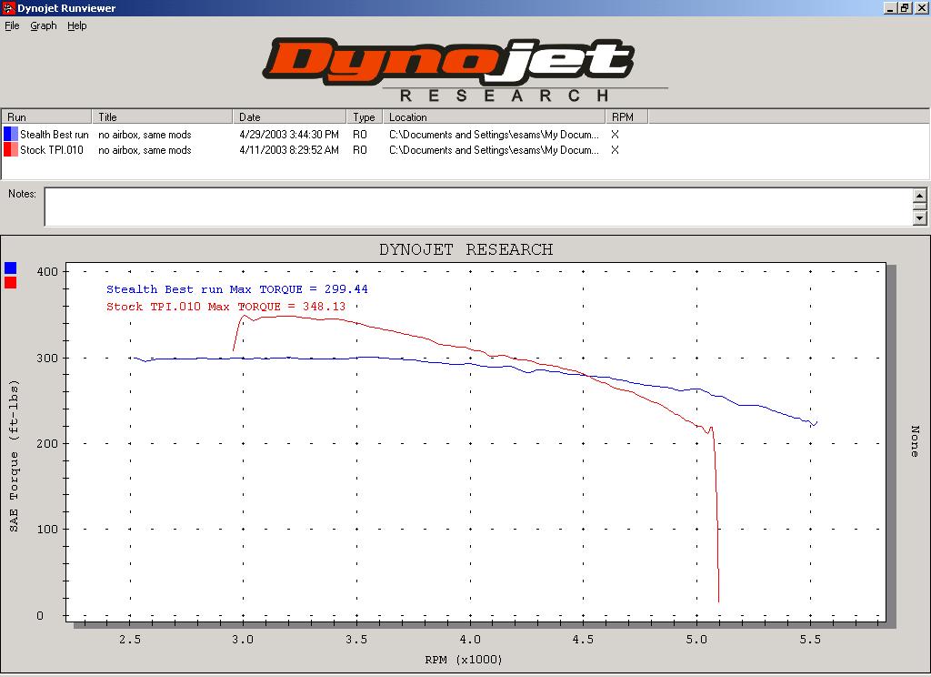

For further clarification, we'll do horsepower and torque separately. Here's torque:

Not to bust you bubble, but if I spent $500 on an intake manifold and only picked up 10hp and lost ~50lbs of tq, I'd be pissed. Yes the powerband is moved up into the higher rpms, but seriously, you picked up 10 hp?!?!?!

Ten horsepower peak gain. Its not the peak hp that makes for a faster car, just look at the way the HSR band continues after the LTR drops off into oblivion. Its a much broader curve, and if hes planning on more mods after this, he can take advantage of the extra flow. Youre also overlooking the fact that this intake was put on a car with heads and a cam designed for TPI. Theres a lot of potential here...

free bird: I agree with formularpm. The HSR leaves a lot of room for future potential with not only heads/cam combination, but also for your tranny/final gear ratios.

I don't see the big gain. Everything has potential, but there's no way I'd be happy w/ that. Why buy an intake designed from a dual carb setup to "help" a stock TPI motor? Helping a STOCK TPI would be runners, a port job, a cam. Not miss matching something that severe. One would've gotten better results w/ buying some slp runners and a dremmel.
I knew the numbers weren't going to be that great, but I expected a little more than 10 PEAK hp. He lost 50lbs of tq that would help him get out of the hole. Unless he couldn't drive before I don't see him get more than a tenth faster than what he did w/ the TPI.
Look at the rest of the curve. The ONLY gains I see are the ones after 4500 rpm. and yes they are good. But I seriously doubt that motor is going to push the car any faster down the track.
I do agree in the fact that the HSR leaves room for a lot more mods. But why get it dyno tuned for an intake? I know it was a little more expensive than a typical $75 session. Why wouldn't you buy a cam w/ that money and pull more than 10hp better w/o it even being tuned.

Well Freebird, there are about five ways I could respond to that.
The average person and amateur performance enthusiast would say, "Yeah I know. The Stealth Ram sucks, don't buy it."
However, my response is this.
First of all, don't expect to get the most out of any modification without changing the computer's fuel and spark tables. For newbies, this means a new chip, or DFI (Do-it-yourself Fuel Injection, hehe)
Second, look at the horsepower difference from 4500 to 5200 rpms. It is significant. That is all I care about. The reason is because I have installed this intake to go along with my new Yank SS3600 torque converter. When I'm racing, my rpm's will never drop below 4500 rpms after the shifts.
Third, with the stock torque converter and my 3.23 gear, it's pretty obvious that I can expect my car to run a slower ET and lower mph than the 13.59 @ 99 mph it pulled before the intake swap. I also believe that with the new torque converter and headers and a correct chip, the car will be one of the first stock longblock L98's to be comfortably into the 12's, at 103 to 104 mph. This will require low 1.7 to high 1.6 60 foot times, and this torque converter is capable of such (but my drag radials aren't).
I personally find it exciting to see that the Stealth Ram is just starting to come alive at 5000 rpms!

Wasn't an exercise to get maximum performance, just to see what bolting it on to a stock engine with no mods would do.
I've tuned stock eliminator TPI cars (with the C950) on the dyno and the TPI intake really does cause power to absolutely fall off a cliff, even with a "square lobe" stock eliminator cam.

You have serious gains left to be had with just a new EPROM being burned with a good A/F curve.

Anyway guys, my take is that after you've done all the basic bolt ons and have hit the stock TPI wall, the HSR makes sense on a stock motor if you're willing to do either gears or higher stall or both around the same time to take advantage of the new power curve.
Also remember that on street tires, stock TPI is no picnic to hook up on launch, so less torque may actually be your friend, as sick as that sounds. Check CHP's Stealth Ram test in last month's issue. Notice they gained .4 in ET but only 1-2 mph. Hmmmm, could that be because of less tire spin?
I have driven a HSR intake car and was rather dissapointed. A huge loss of low end torque, almost like a bog.
Check out my sig. I have every known bolt on for a TPI (except an ignition, which is soon). With tuning and lots of practice launching, my car will be the 1st L98 run 12's with shortblock, heads and cam never removed from the car.
The best of both worlds intake is the Super ram. It is halfway between the LTR and the HSR or miniram. You keep most of the low end torque and move the high RPM power band up much higher.
Thanks for posting the dyno graphs. Even though the results were not all that impressive, you posted the info anyways. That is to be applauded!!

Here's some pre-track speculation for anyone who cares.
My biggest probem with the car now is 3rd gear. On the 2-3 shift, it drops all the way down to 3,000 rpm or so and takes way too long to climb back up where I need it to be.
Getting out of the hole is obviously important, but so is 3rd gear since it has to pull us through the last 3/8 or so of the quarter mile. That's where we really need to be smack in the middle of our power band, which I am now definitely NOT with the stock converter and the 3.23 gears.
I'm ranting about this torque converter because it's designed to be one hell of a band-aid for not having a low gear, but a lower gear would be even sweeter.
Check these comparisons. Since we know that my car will trap between 97 and 101 mph, look at where the rpm's would be at with a locked up torque converter. Don't laugh at my crappy cut and paste job, it's from f-body.org's gear ratio/mph calculator.
Attached Thumbnails Stealth Ram thread-dyno/track on L98-compare.jpg

Ugh! I was all excited about installing the HSR and seeing how much MORE power I got and now the dyno tells the truth. Mine is now on the car, and I am just Earl Fittings away from firing it up (Damn Summit and their understocked warehouses!) The car is sitting there awaiting only those fittings and hooking the battery back up......
I hope that some tuning will make the HSR perform like it should.

I know a lot of you guys are bummed out with the dyno result, but
I seriously can't wait to show you what happens at the track before and after the converter.
