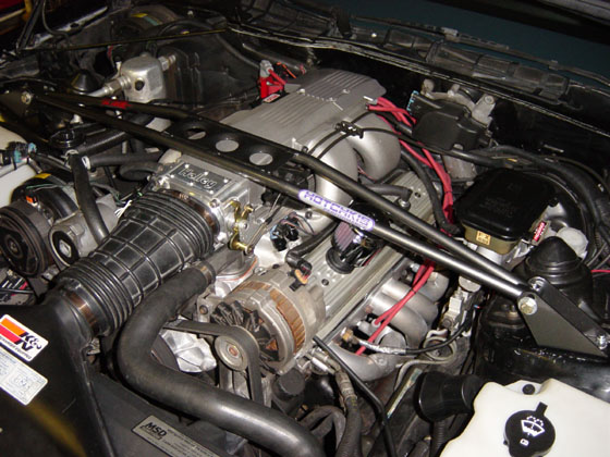

Build exactly what I built, but instead, get 8.5:1 forged pistons, get a scat crank, lunati rods, and buy a ATI Procharger D-1SC pushing 15lbs of boost, buy 36lb injectors, then buy F.A.S.T DFI with wide band o2 option. That should be under $10,000. It should also make ~500 - 600hp and be very streetable. I'm going to put a P-1SC on my car @ 7 lbs. boost because I'm running close to 10.5:1 compression. Here's my motor:
