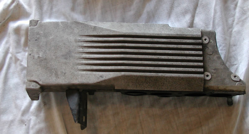

I have an 85-88 Plenum that I will be putting 4 sale...I also have the bae so you can port this one out and leave your stock on the side...let me know if your interested, I don't want a lot of money

how does $50.00 sound?
Not sure what it's worth.....I see ported ones sell for $100-$150 so for sure not that much.
Here is a pic
