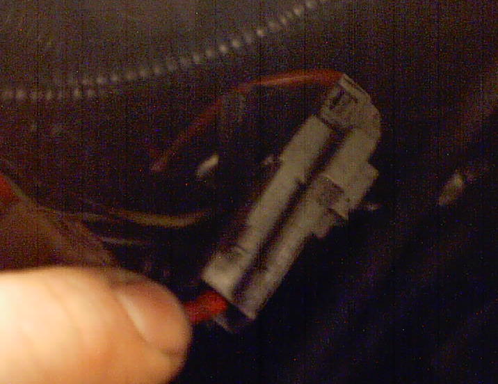

no that wont help i looked for that connector but all i found was the est connector . i dont kno what ill do i didnt find any stray wires either. what color is the wire on both ends of the connector?

actually yeah a pic would help if you wouldnt mind. thanx alot

here is a pic for you:

like i said before, it is on the passanger side firewall in the small harness that runs along with the big harness from the ecu. hope that helps
