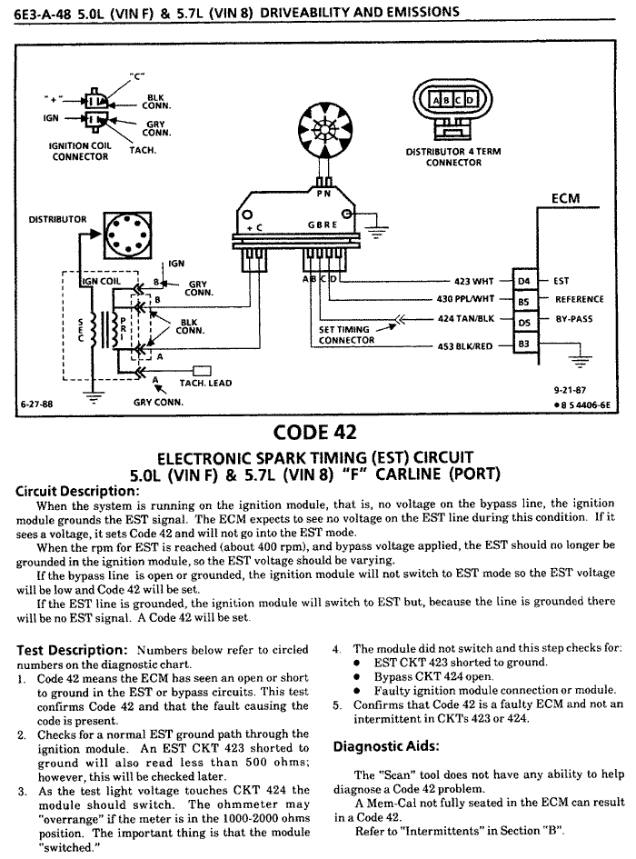

After installing everything, the motor fired up and I set the initial timing to 6 degrees BTDC (ESC bypass disconnected). The motor idled fine after a couple minutes and everything seemed to be fine. I took it out on the street to drive it around and everything seemed ok. I went to shift to 3rd and gave it about 60-70% throttle and there was a loud backfire and my buddy who was following me said he saw a large cloud of black smoke come out of the exhaust. The motor then stumbled for a couple seconds and died. I tried restarting it but it only turned over and wouldn't start. I checked for codes with my scanner and a code 42-Electronic Spark Timing came up. After messing around with the leads coming from the ignition module I still had the same problem. I figured out that I get spark when I turn the motor over but the injectors aren't pulsing. I replaced the ignition module with the one off the old distributor but that did nothing.
I read somewhere that a code 42 can be set if the EST and bypass wires coming off the ignition module aren't getting the right signal. At one point one of them is supposed to be grounded and the other should have voltage. Does anyone know anymore about this problem? I need to get this car off the side of the road ASAP. Thanks in advance for any help.

Maybe this troubleshooting chart will help you figure it out. BTW, are you going to school at Clemson?
