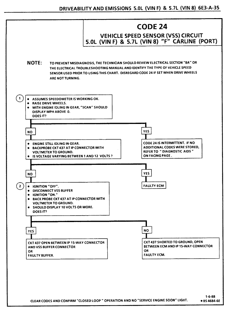

i have an 88 tpi 5 speed im getting code 24 y and how do i fix it

Welcome to the board. Code 24 on your car is for the Vehicle Speed Sensor (VSS) circuit. Here is a trouble shooting chart that might help you figure out and solve your problem.
