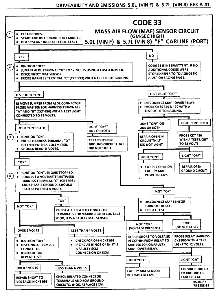

code 33
i have a 87 iroc camaro with a 5.0L efi v-8. In the afternoons on warm days, I will start driving and the car will go in to the "limp Home mode" where it will cut back in rpms and cuts my accerlation down to the wick. i have replaced the maf and i was wondering what could be causing this to happen. HELP!

Check this chart out and see if it will help you any.
