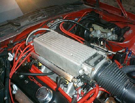

If you already have a TPI unit then all that you need to really get is the HSR, plenum, base intake, and the fuel rails.the rest of the parts are up to you, if you want to get new injectors and a new throttle body then go for it. But you don't need to buy the wiring harness and everything because you already have one of those, i think that the only problem you are going to run into is that the HSR is EGR delete. Best of luck man, any other questions just let me know, I already went through all of that mess myself, it really isn't that bad.

Hey IROCING, did you feel the extra 20-30 HP as described in the advertisement?? Another question.. how much if any programming, if any, is required??
BTW.. nice lookin engine bay. I hope to have the same soon.
