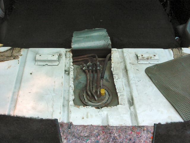

Fuel pump install is not that hard!!!
where do i stand? is this a hack? I did this as part of a fi install. I cannot get to both sides of my car in my gararge so a tank drop was out, my driveway is about a 25 degree incline and i no longer work in the street because i want to live. I was also chasing fuel delivery problems and figured this might help.
Laiky-I think it looks good...its neat/looks safe...
Yeah I know it was not "crash tested"...but neither is all the other aftermarket stuff we throw on our cars either...
I guess some will say if you get rearended hard enough..the plate could pop out or something...I don't know..

Originally posted by laiky
i didn't have them at the time, i do now. i just havent put them in yet. I was contemplating aircraft style nut plates but again time is always short. Since my car is no longer a daily driver i'm hoping to spend some weekends doing a number of detail upgrades
also, if i had to do it again i would hole saw the corners, eliminates and potential stress raisers. I did not know how close the tank was so i gradually cut through with a grinder. Hindsight being 20/20. i should have cut a smaller hole and checked for clearance then hole sawed. Either way the pilot bit will come VERY close to the tank if you dont loosen the straps.

laiky,
How do you seal that ridge in the middle of the floor, You are using a flat plate?
Any fuel vapor issues?
anesthes,
Do you cut holes in customer cars? I just want to make sure I am reading this right.
If so where do you work?
anesthes,
The only way that I can see this not being a hack job is if there was an actual frame fabricated around the perimter of the hole and have it welded to part of the frame work of the car. This would provide the car with some structural integrty to make up for what was removed. I think that there also needs to be some actual weatherstrip to seal the hole. The cut should als be sanded smooth and the surface painted.
However I do not see enough space to accomplish this.

Originally posted by jonarotz
anesthes,
anesthes,
But if a friend or a frienf of a friend calls and asks for something custom, I may do it.
I "Cut a hole" in my car a few weeks ago. Yep. Driver side battery tray, 4" hole for the air cleaner plumbing off the blower. Ran the air cleaner down in the front behind the fog light.
Wait a month from now when I cut more holes for the intercooler! You guys will be really upset with me. But, I expect to be running 125-128mph in the 1/4 next season so
If your wondering if I'm a mechanic full time? *** no! I grew up at a dealership until my family sold it, and that was enough of that field for me. I went to school for software engineering and have been doing that for 10 years. I'm also a reserve Police Officer, which I enjoy better than both cars and software, but it pays the least of the three.
-- Joe

im not into cutting the car anymore after what ive read. i dont think its a hack job if done right and an access dor is installed (the ONLY thing i would be worried about is structural suopport but a roll bar can fix that...) i did have a couple questions though...
First - what did you do to the exhaust to get it out of your way???
Second - all i have is the pump...no harness or anything like that. just the metal cylindrical pump....do i need anything else?? (the reason i ask is because Racetronix that sells aftermarket pumps for the tpi cars sells a aftermarket fuel pump harness too...heres a link)
http://www.racetronix.com/product/RX..._Pump_Kit.html

You'll think its not a hack job right up until the point fuel enters the passenger compartment.
I can see doing this on a race car, or maybe if you spent all the time you'd spend swapping out the pump by dropping the tank on making a proper fuel pump access door (like Nissan, Dodge, and various others do), but I have yet to see anyone doing that and therefore it is a hack job. Calling it anything else is just trying to make yourself feel better. Also, using a compression fitting isnt a good idea either, where are the flared connections? Non-existant, thats where they are. I've even seen heavy use of only hose clamps... another bright move on a 50+psi line.
When you guys start cutting into your firewalls, floorboards, fenderwells, etc to get to things like plugs, heater cores, fuel filters, oxygen sensors, and other various components easier than sliding yourself under the car then maybe I will not call it a hack job anymore. I cant think of one single person who has done any of that, and yet cutting a fuel pump door is 'smart' and 'not lazy' but not drilling a few holes in the fenderwell to get to the plugs (something that everyone changes way more than a fuel pump) is totally lost on everyone... or something.

How can you compare plug access and fuel pump access. The last I checked, you don't have to drop the front end to change the plugs.

Originally posted by ZZsmpch
I ain't taking sides here, but I don't think I'd want 17 sharp points aimed at my tank. Reminds me of the Ford Pinto.

The last fuel pump I did in a 88 TA took me two hours to do the right way. If I take my time it takes me about 3 hours or so with just normal hand tools. One time when I had a friend helping, we did the fuel pump in about an hour 20 on his 91 Z28 (JaysZ28)..
It doesn't take long to do it the right way.

Originally posted by Tibo
Is there any one who would argue that that picture in the link was not a hack job?
-- Joe

Maybe there are some people that do it right, but I havent seen one yet. Go take a pic if you did. I have another like this at home, different than these two. There was even a guy who chased the fuel lines all the way over to the shock tower. Now THAT was pretty. And thats what most people do (at least every example I've ever seen), and you wonder why I call it a hack job?
