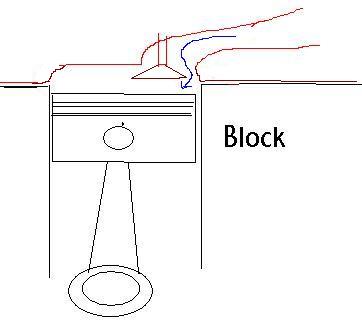

1MeanZ-
Here's what i think is happening to your car. Since you are running the L98 Vette heads, the chamber diameter on those is bigger than a normal 305 head would be. This causes a disturbance in airflow that i have shown in the picture below. I think if you swapped over to a set of ported - LB9 heads it would benefit you alot.
Also, the Vette headed intake valves are 1.94"... which can cause valve shrouding. you probably already know but this is why many people shy away from building up a 305. You can get alot more flow with the bigger bore.
When you stuff that bigger valve in our small bores, the air/fuel has less room when going around the valve and into the bore. I think the 1.84's are actually alot more efficient.
Attached Thumbnails Whos got the baddest NA 305 TPI?-c-documents-settings-chris

Here's what the flow would look like with an LB9 head on a 305 motor

Damn, heres the pic

tunedport 335, those vette heads have the same sized chamberes as yours and mine do.
Yeah, total volume, however i do beleive the diameter is different.
Aron213 on the boards showed me one time, he measured them out with pics and everything....that was a few years ago.

no offence or cockyness mw66nova u must be confused dont the vette heads have a 64cc chamber. our 305 heads have a 58cc chamber. those vette heads are from a 350 hense a 64cc chamber. thats what i thought anyways. somebody correct me if im wrong
