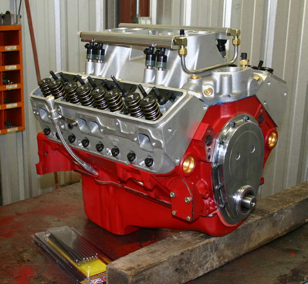

Stealthram 383 what do you think??
Heres my new motor going in mext week.
Chevy SBC 350 block
Holley Stealthram w/30lb injectors
Eagle 383 balanced rotating assemble w/SRP pistons
and 6.0 rods
Comp Cam Custom grind cam changed Lobe sep. from 110 to 112
Lift .502 .510
Duration @ .050 224 230
108 Center line
Comp cam springs and push rods
Comp Cam pro magnum roller rockers
Alumnium Heads 64CC angle plugs
Attached Thumbnails Stealthram 383 what do you think??-c-documents-settings-administrator

Youre project is mirroring mine except, my cam is .544/.555 lift and heads are AFR w/65cc. I'm a few days behind you though, I'm painting my block right now while I'm waiting for my micrometer set to get here. Youre motor looks sweet, it's gonna haul!!

What are you up to in cost if you don't mind me asking?
Chevy SBC 350 block, bored, freeze plugs, cam bearings, free
Holley Stealthram w/30lb injectors $2200
and 6.0 rods $1200
Comp Cam Custom grind cam $260
Alumnium Heads 64CC angle plugs $1000
Timing cover $50
Lokar cables, bracket, and oil stick $200
Misc parts and gaskets about $400 to $500
k&n filter $40 i think
ARP bolts $200
Valve covers $100
Parts from my other new motor
Comp cams Pro magnium roller rockers $250
Fuel lines AN6 w/fittings $100
about 5000 to 6000 i probuably forgot something. Plus you can add my new diff for my 9 bolts $900 and C4 brakes from Ed miller $675. anything else you want to know ask.

what oil pan did you go with?

just stock money matter starting running into the works. so i didn't get everything i wanted but i'm happy.

Did you have to do any clearnecing on the pan? I do not hear to much about people using the stock pan.
i run a stock pan on my 388 , i think the differance is if you use a aftermarket rod or a stock gm rod and also if the machine shop clearances for the stock pan baffle, i have also seen stock pans that were made for 3.75 stroke i mean they had a 3.75 stroke in the sbc 400's so it is not totally unreallistic that a stock pan would work
Agreed. Is there a difference between a 350/305 pan and a 400 pan?
I tried today and thanks for asking because i forgot to check that. Only had to dimple the pan on the driver side ner the rear. 2nd bolt up. only had to hit it out 1/8 inch. thats it. thanks alot and alls good now.
I don't think so, other than 400s have the dipstick on the driver's side, which is what I think it was for all 1980-earlier SBCs. I've bought the generic $30 oil pans from Summit before for my 400 and they fit fine.

I used one of those summit pans on my 400. I didnt think there was any problems either. Until I pulled the motor for a rebuild and found out the crank was hitting the side of the pan. Right at the rail area. You couldnt hear it because of the loud exhaust but you could see it on the pan. I just hit it a few times with the hammer before it went back together.
