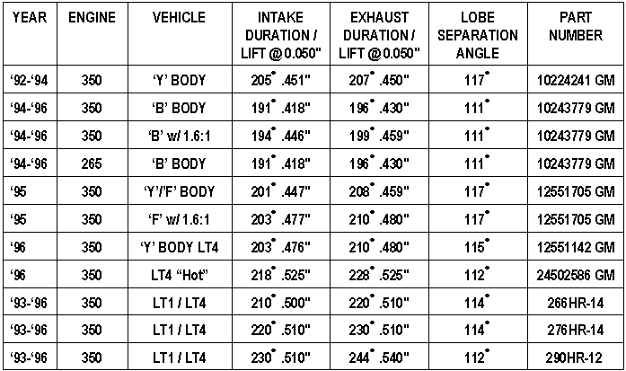

There are a few different LT1 cams out there, so the performance increse will depend on which one you get.
RMK
Which one of those cams will go good with a 91 LB9? And by good i mean lots of tire roasting power!
