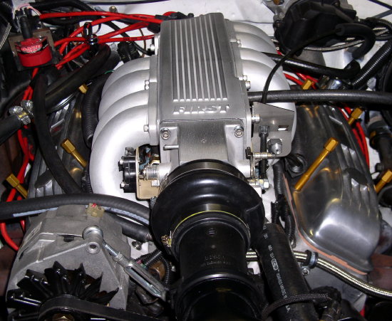

Me also!!!! I haven't been able to work on the car as much here lately as I would like. However, I should be riding around in it tomorrow (Sunday). It's suppose to be bad weather here,, so I doubt if I can get it to the track this weekend. Hopefully there will be enough break in the weather, that I can test a few chips and see if I need to burn a new one.
Originally posted by 377Z
Also, can you give a general rundown of the 350 it will be run on?
I've included the sig this time.
This thing looks right at home in the engine bay. This test fit pic shows off the mono blade throttle body and give you a good idea of how large the runners look on the engine.

I finally had some time today to fine tune the set up, getting it ready for the track when it opens. This thing is absolutely awesome. I adjusted the valves with the car running and played with the tune a little. The initial impression I had from the FIRST was very good, but I was running the same chip for the FIRST unit as I did in the StealthRam. Now with a better suited chip / tune,,, this thing zings to 6000 rpm in a flash,, shift points will probably be between 6000 and 6200 rpm,, which is a little higher than I orginally estimated.
I bought another FIRST unit because I could not wait to start modifying one for the 406 in my SS. It's at the machine shop now getting a little extra material welded to the top. My 406 heads are standard port heads,, but the porting was offset (raised up). So even though you can port this FIRST unit to a 1207 gasket in it's normal position, since the port on mine was "raised", the intake requires a little extra welded to the top in order to seal up. I'll post pictures of the modified intake after I get it back and have had time to hog it out.
Old Feb 19, 2005 | 07:18 PM

The local track opens April 2nd and the car is sitting on ready! I should have the welded intake back from the shop next week and will post some pictures as soon as I fully port that one.
I doubt that I will get flow numbers on either the stock or ported FIRST. I'm bolting the ported FIRST to a set of heads that flowed 328cfm at .650 lift,, which is at "cam lift" for the cam I'll be using. So,,, if it does as well as I expect it to do,,,, and it doesn't choke these heads down,, then it's save to say it will flow good enough for 98% of the heads it will fit.

Finally,,,, some ETs
Box Stock FIRST Injections intake - Best run in 80 degree temps with mild pocket port / clean-up on the G1 heads with 5800/5600 shift point
60ft------ 1/8 ET -----MPH ------ 1/4 ET ----- MPH
1.707 --- 7.992 ----- 85.526 --- 12.599 --- 106.702
That's a fairly impressive 60ft time and was somewhat unexpected for this power level engine. However, the power band for this FIRST intake is about perfect for this combination (355 with 3.23 gears). It didn't feel like the car was dropping off in power up to 6000 rpm, but the ETs showed the car liked to be shifted at 5800 out of 1st (5600 rpm shift caused spinning into 2nd) and at 5600 coming out of 2nd gear. Porting the runners to 1.8 - 1.82" would improve on the time and mph.
__________________
Just for reference purposes - not an apples to apples comparison!!!
STEALTHRAM - Best run in 80 degree temps and box stock TFS G1 heads with 6400/6200 shift points. 3.23 gears & 26x11.5 ET Streets.
1.803 --- 8.133 ----- 86.37 ---- 12.673 --- 107.84
That StealthRam rolled off a lot of bottom end compared to the fully ported stock base and SLP runners. This FIRST unit isn't as violent as the ported stock base / SLP combination off idle, but it is a VERY happy medium between the two systems.
