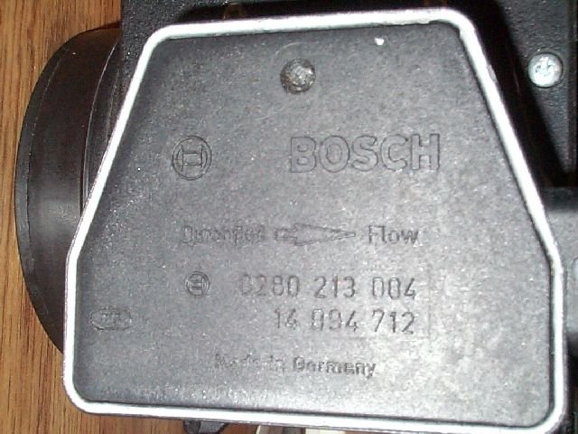

Did you find the part number on the MAF yet? I'm guessing that it isn't the same as this one:

0280213009
10055877
it looks exactly the same, those are the numbers on the bottom of the maf.

ok, then maybe it is the maf sensor. i just checked my factory one and it matches the one vader is showing.
i just went and checked a parts sight and they list those cast numbers as a borg warner new one.

That number should be a valid analog MAF. If you have no voltage at the burnoff terminal and are reading 2.5VDC at the analog output (with a reliable meter) the MAF is toast.
