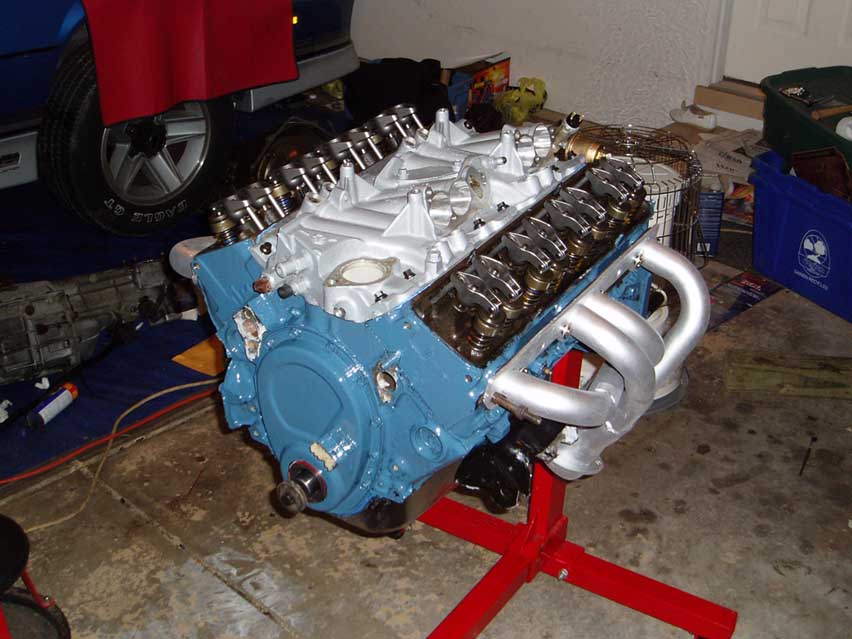

Just get out the die grinder, a carbide bit and grinde away! I opened mine up to match some SLPs that i worked on. Make sure you properly modify some gaskets to make it all fit right too. I ended up just using some TPIS bigmouth gaskets and opened the base and runners to match those. They wont be perfectly circular, but you can make it close. Due to the way the stock base is you have to take more from certain areas than others anyways. Otherwise you run the risk of punching a hole through in places where there isnt much meat.

MAN SMURFIN, looks like you opend that sucker up, is that the factory intake, that sure looks good. So you done that with just porting tools. Have you fired that thing up yet, bet it sounds good. If you have some more shots of it would you please send it to me or post them, maybe some close ups so I can see what you have done...THANKS

Yes that is the stock intake. And yes I have it running. It pulls alot harder above 5,000 rpm and doesnt fall on its face at 4,500rpm. Yes, I have some more pics I can post but thats on another computer so I will have to do that later. All I used was a cheap air die grinder and several different shaped carbide cutting bits.

hey, sorry it took so long. I had some issues finding the files. I hope these help. I know the port job isnt as extreme as some, but it is more than adiquate for my LB9. There is much more room for porting on the side of the base that goes to the heads, but as of now my heads are stock so they are untouched for now.
