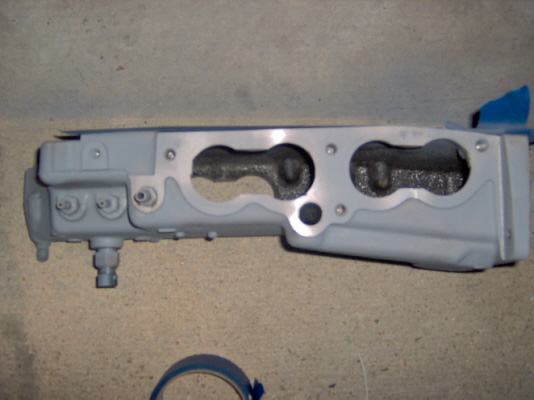

Heres one of your options. I did it on my stock 305 and noticed a low end gain. As in i could break the tires loose when i originally couldnt. Ill try and find the pics of the EGR walls i knocked down behind the TB. When you take the plenum and TB off you will see what needs to go. Its right in front of your face. This is a siamesed plenum though. Take measurements of the plenum, gasket and runner opening and try to match them up as well as you can. I also radiused the runner entrys just for the heII of it since they are at a 90* angle to the flange. I figured it couldnt hurt.
Are you using that with stock runners? I'd guess you had to take a set of cutters to your gaskets as well.
Old May 27, 2006 | 04:57 PM
  #43
91GTABird's Avatar
Joined: Aug 2001
Posts: 972
From: Memphis, Tn
Car: 92' RS
Engine: 357
Transmission: TH350
Axle/Gears: 4.10
Yes. Thats plenum is connected to a set of stock runners. Kind of embarrasing aint it.
I just put the gaskets on the plenum and used the same bit i had been porting with slowly cut away at the gasket until they were even with the plenum ports. I then put them on the runners to make sure they lined up with everything and i wasnt going to have any leaks.
