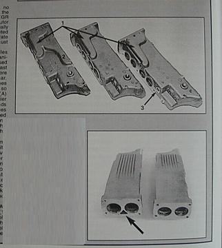

The plenums from 85-88 are all the same and then switched to SD from 90-92 I believe. Not exactly sure on the 89 plenum, I think the only difference is that it doesnt have the 9th injector.
heres a pic from an older thread
heres the thread https://www.thirdgen.org/techbb2/sho...ht=tpi+plenums
