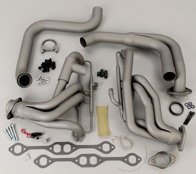

Would it be possible to install headers for an '84 on an '87 TPI.
Here are the ones for an ;84
and these are for an '87:
It looks like I can remove the stove/heater thing, use an elbow on the drivers side air tube, but what about the Y? It seems like the shape may be the same but the joints are in diff places. Does anyone know if this will be an issue?

Aside from the heat stove connection, the Y pipe should be the same shape, just the outlet is 2.25" instead of 3".
Also, the 84 Y pipe most likely incorporates the use of the vacuum controlled flapper valve on the passenger side that helps the carburated cars warm up faster.

the LG-4 84 system was 2.25 ... The L-69's was 3 inch ... the flapper thing can be replaced with the non flapper spacer.
