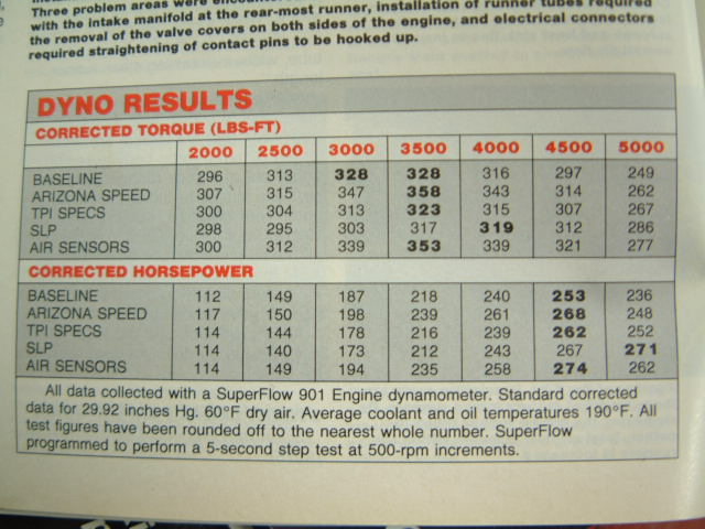

There was an article around here posted that had dyno numbers comparing different intakes. A few LTR setups were in it, including an AS&M setup. The dyno's were all done on a 89' L98 Corvette with a CAI and edelbrock headers and exhaust I believe.
For the most part the AS&M setup with a stock ported base was THE best performing intake it seems. Making more power than the First Injection TPI setup up to 4,500rpm, after that the First setup made a bit more power at 5,000rpm.

They didnt include the edlebrock runners . I have seen the SLP ...and Edlebrock back to back ....and the SLP 's were a bit smaller in diameter than the edlebrocks

Pulled this off of Stealthram.com take the data as you will. I can't verify its accuracy, though it does seem accurate.
