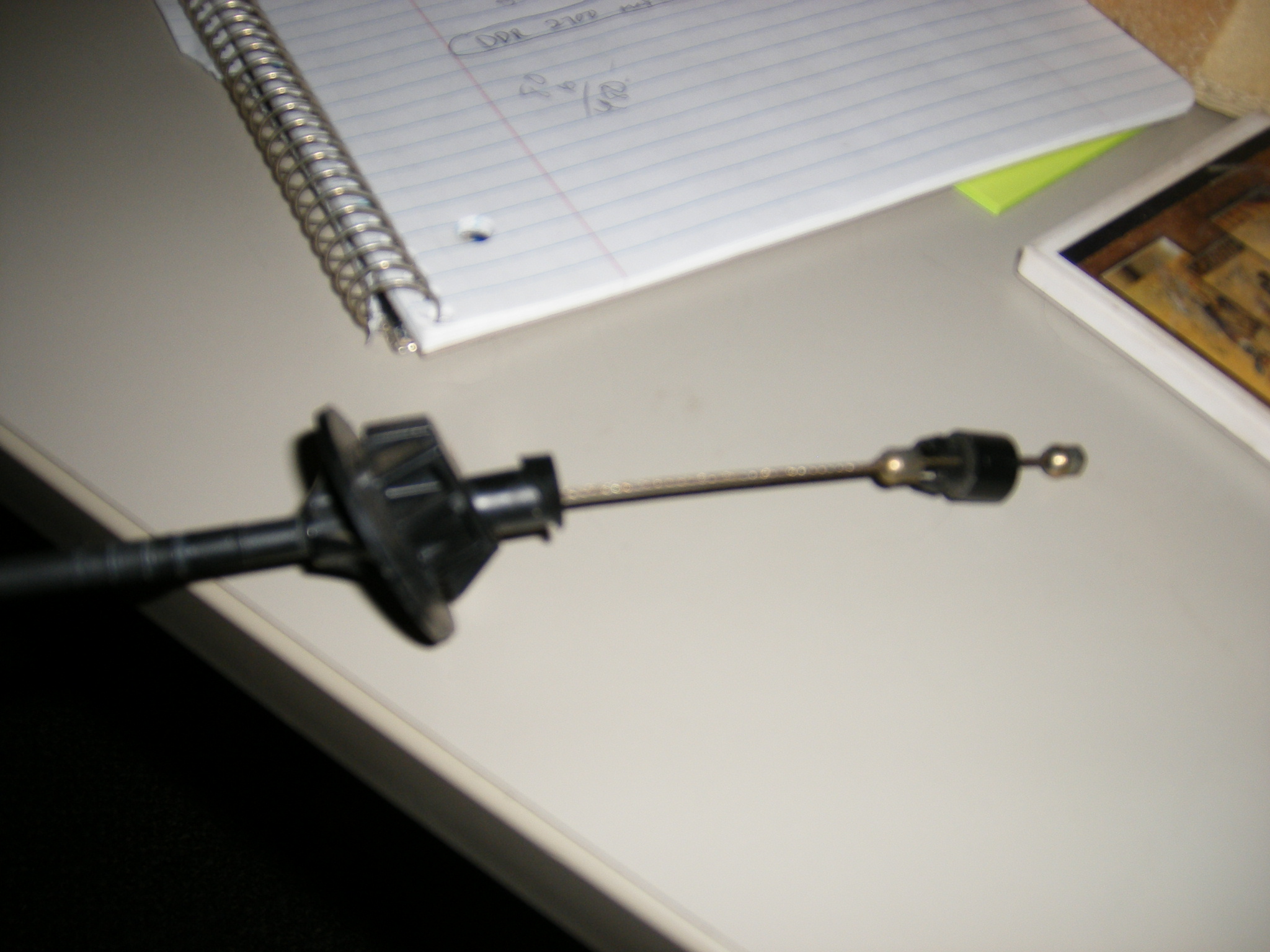

here are a couple pictures of what I have....

That's the later throttle-arm setup with the accelerator cable cam.

Doesn't look like it. The original P/N should be 10163879.

I also have this, what does it go to, can't figure out how it would hook up..

That looks like the end of your throttle cable that would go through your firewall and connect to your accelerator pedal.

thats def. a throttle cable for a thirdgen.,but which one?
If your tpi setup is from a 90-92 it is speed density which is quite similar yet different than your 89.
If you are running a speed density setup,you will need cables from a 90-92 including the cruise control.

Well that is definitely your throttle cable.

The pic in post #15 is clearly the 85-88 style throttle cable. You have an 89-92 style throttle body on your setup. You can get the correct, original GM 89-92 style cable you need from tpiparts.net. I'm pretty sure the cruise control cable is the same for all years of TPI. I've heard in a couple of posts that the TV cable changed around 89 or 90, but I'm not completely sure if that's true. You definitely have the wrong throttle cable though. Angel, the guy who runs tpiparts.net, knows this stuff very well. I'm sure a quick email to him would answer whether the cruise and TV cables are correct or not. Btw, stick with original GM for the TV cable. Those universal, aftermarket type TV cables like you posted in #11 very seldom work right. Just the fact that it says 82-92 for the application is enough to shy me away from trying one of those. TPI, TBI, and carbed thirdgens all have specific length TV cables.
