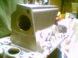

I did some measuring last night. Well, the Ram Jet is exactly 1 inch taller at the TB than the TPI setup. The TPI slopes down to give more clearance where the Ram Jet is just flat.
I took a socket (about 1inch tall) and set it on top of my TPI plenum on the 88 and the hood did shut. Keep in mind that the socket is only 9/16s wide or whatever and the Ram Jet manifold is like ~3inches wide at the top.
I think it will clear the powerbulge hood. You might have to cut or modify the hood's structural support on the underside a bit right above the TB, but I really think it will work.

OK Joe I will take your word for it on the hood clearance. I did notice while looking at some of your pics the other day that the Ramjet T/B already tilts down at a good angle, so that should help me out. Your engine had to have been tilted back at the bellhousing when you shot the pics if it's only an inch of diff. OK then my Ramjet project is back ON! Now where's that S&D phone # and my CC?

Yeah we already talked about the hoods not being flat in private. I am going to say that it has got to be VERY close, but not sure without a stock hood bolted on a Ramjet engine, it's hard to tell. Guess I might found out first?
