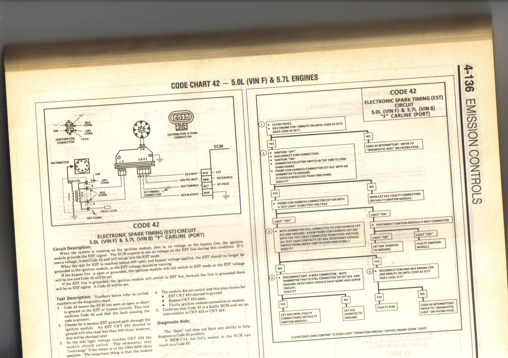

Code 24 is a problem with the vehicle speed sensor circuit. Your car has one. It is located behind the instrument cluster mounted on the speedo. You will have to remove the cluster to get to it. I attached a chart for your code 42. Code 46 is a vehicle anti-theft system problem. If the car cranks and starts, you should be fine but might need some diagnosing in the future.
