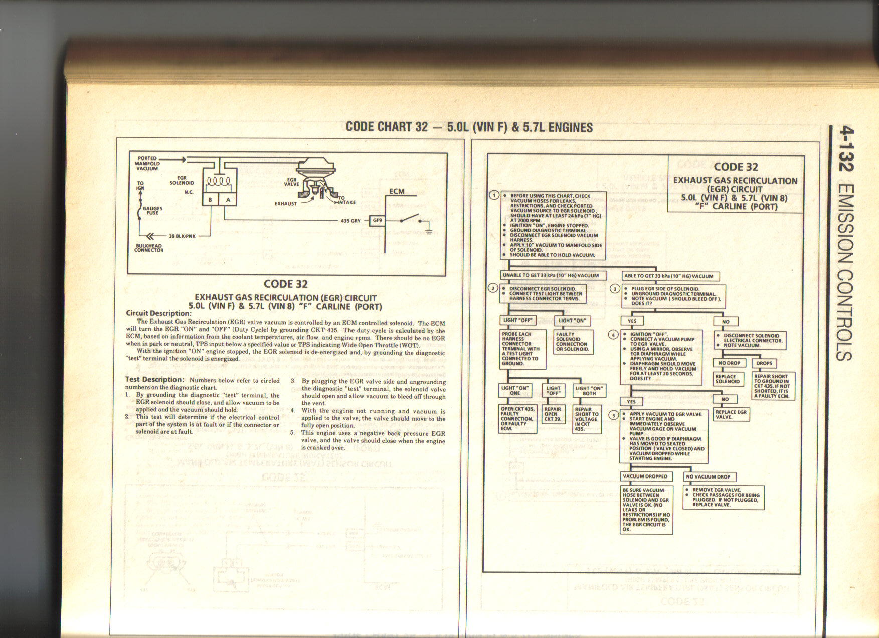

Here's a chart for the code 32. Should get you going in the right direction.

so it says by code 32 thats its an egr circuit or whatever. do i gota do alot of wire work or could i just replace the egr valve and would that correct the problem
