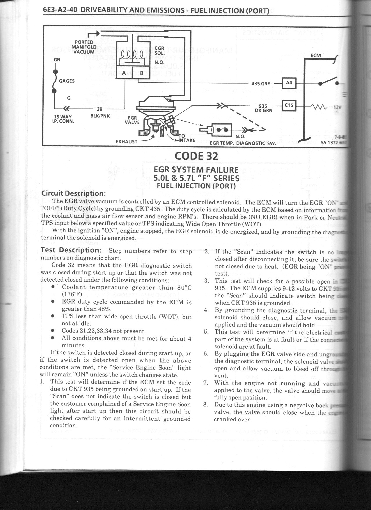

You don't say what your car is, but if it's one with the EGR temp sensor, that's what it's likely complaining about. Here's a page from the '87 shop manual if it helps.

Its a 92 L98. Sorry, forgot to mention that.
