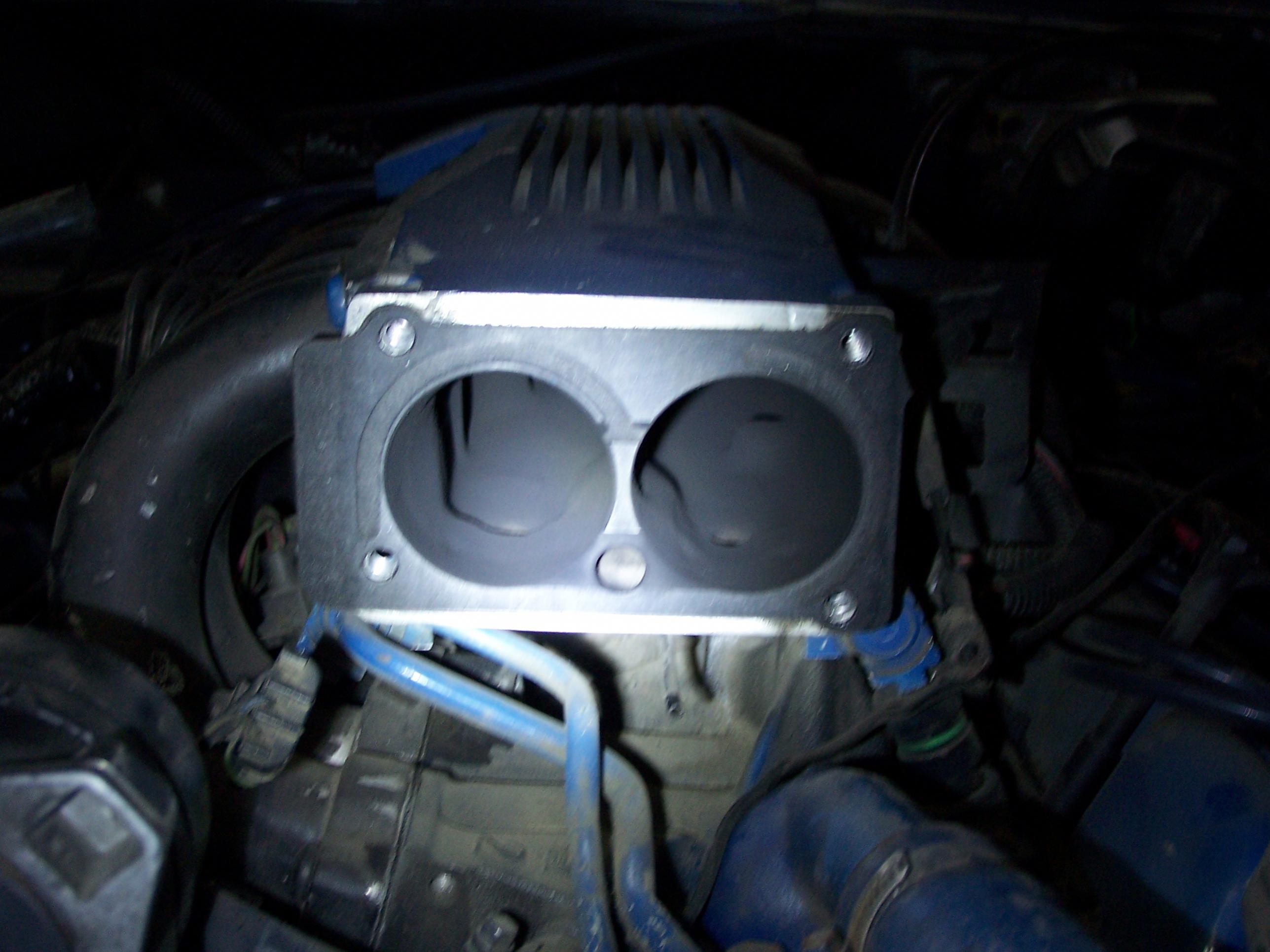

Pulled my TB off today and found a caked on black residue. Has anyone ever expeirienced this before? If so what is this.

Looks like carbon build up.

Its exhaust right. must be the timing?

poor maintenance IMO... ... gotta clean that throttle body every oil change or so ... at least every six months..

some of it is from the EGR valve.
most of it is from the PCV system.
its completely normal.
i've seen them sludged up much worse than yours'.
some good carb cleaner will clean it right up.

that is the unpreventable black crud

Use some Seafoam and Deepcreep on that. That stuff works wonders. Heres a link to the best how to I've found http://www.lt1engine.com/tech/how-to...arbon-buildup/

I just used Seafoam today to remove carbon build-up. It restored some lost power. Smoothed out the idle too. Great for my high mileage engine! (212,000 mi)

do you suggest soaking the plenum inside carb cleaner?

NO DON'T DO THAT.... YOU need to use TB cleaner... Carb cleaner from my understanding has a different chemical structure compared to that of a throttle body cleaner...
