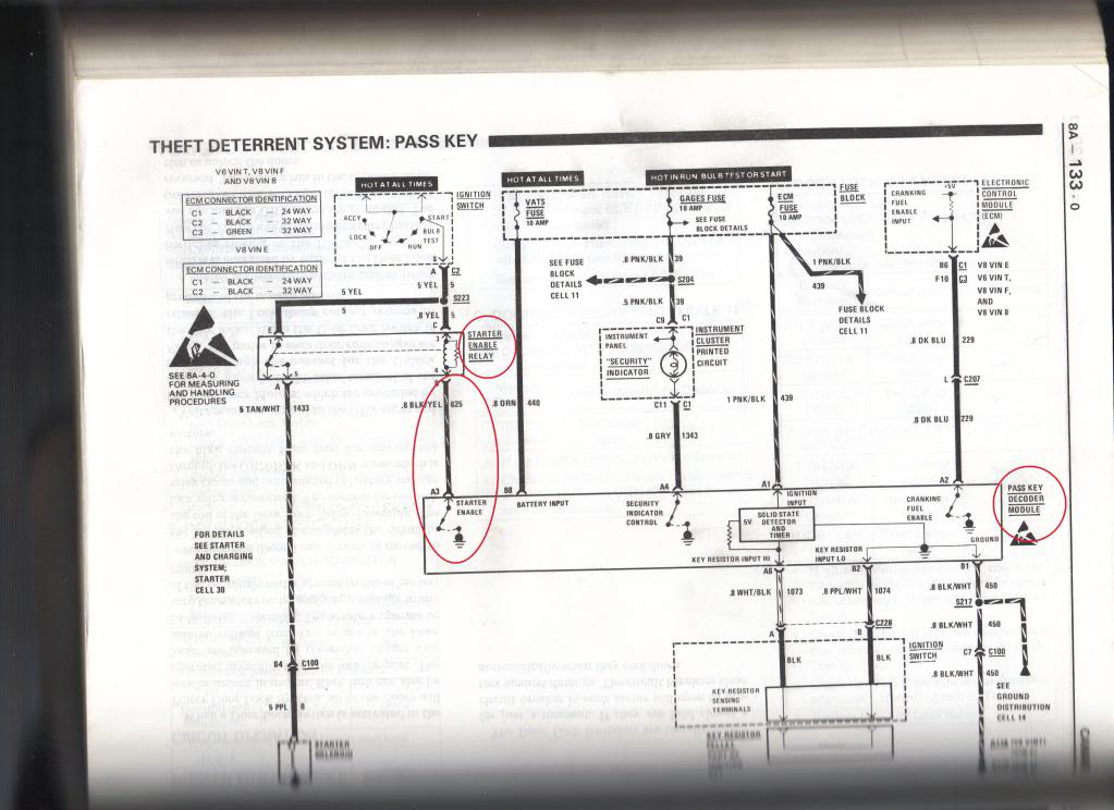

hey vetteoz i just finished with my swap so yest. was the first day i was trying to crank it and there was no crank. today i was going to try some of the things you said but i decided to just go after the starter enable relay. i have the actual service manual for my car so i went through all of it and i used this chart. i jumped the black/yellow wire in this diagram to ground and the car cranked but did not turn on. so i think ive found that my VATS module is not triggering the relay? am i correct? so does that also mean that my VATS is not disabled in my chip and is keepin my motor from turnin on? What do i have to do to actually get my car turned on?

If bypassing the starter enable relay allows the starter to turn, but car does not crank, then yes you have a VATS issue. VATS also disables the fuel injectors. You need a VATS bypass module, about $30 - $50, they are on ebay, as well as Painless and others sell them.
