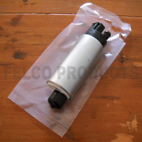

Just the other day, I helped my dad replace his 99 Ford Ranger Fuel Pump. I read the specs and it claims to sustain a pressure of 63 lbs. My dad has had Ford Rangers since the stone age and Ive NEVER heard his howl. The only noise that I have heard is the fine tuned ultra high frequency noise of the whine. The question is, would installing one of these pumps solve the problems we are having?
Incompairison to the Walbro, the Ford Ranger Fuel pump looks almost the same, other than the length of the pump. So, does anyone thing it could work (put Ford pump into the Camaro)?

1. Replace fuel pump (even the cheap ones work fine, people just kill their new one most of the time because they still have restricted fuel lines and this overheats and kills the new pump over time)
2. Blow out the feed and return lines, the sending unit, and fuel rail with compressed air (if air will not blow through your fuel rail then replace your FPR).
3. Replace the fuel sock (usually comes with the new pump) and in line fuel filter.
That's it! Your car will drive exactly like it did in 1985! You don't have to add the fuel diverter at the end of the return line, but it won't hurt anything to have it. You don't have to wrap your fuel lines. I didn't, and I have un-coated headers with no problems and the fuel lines run within a 1/4" of them at the frame rail. And of course, during your fuel system overhaul procedure, don't forget to check all your fuses, grounds, and wiring associated with the fuel pump to make sure it's getting proper voltage.
